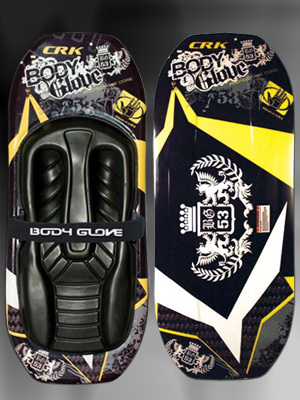

QUESTION:
I know the pole is tubes and the tower is for wakeboards and ski’s.
I just ordered a kneeboard. What is best to use, the tower or the factory pole at the bottom?

As far as what to use for a kneeboard - I'd say tower. From what I've heard the only thing the tower really buys you is the ability to jump a bit higher. A great option for all the water sports EXCEPT tubing.
