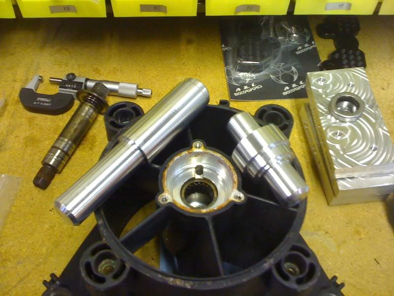

I'm planning 2 tools. One for pressing out... and one for pressing in. The press-in tool will have 2 sides just like the OE tool... and it will handle putting in the seal.

You guys looking for somthing like this?????
I need to make a tweak to the seal pusher... but they will be available next week. I used the bearing pusher to drive the bearings out of ocod's pump today.
