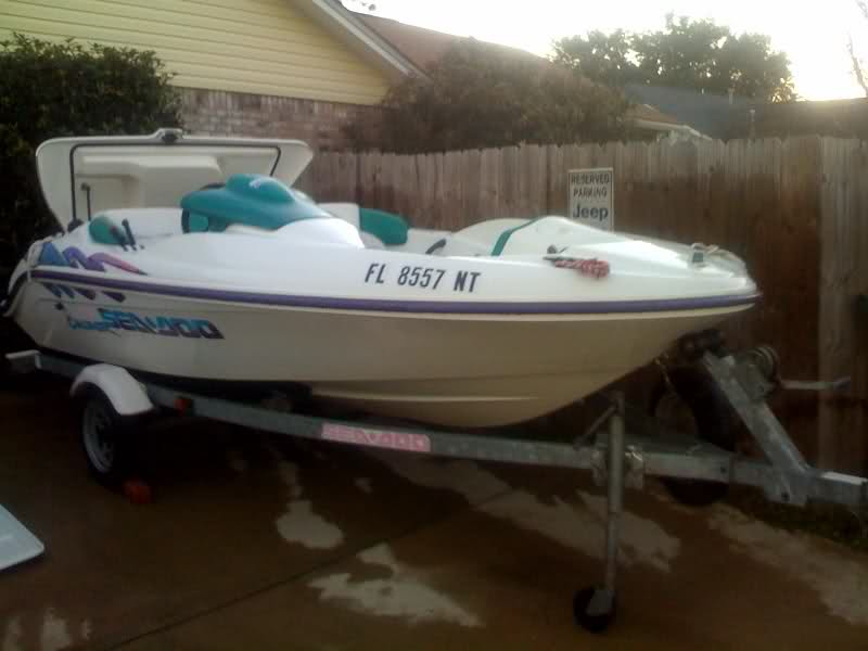

Update 2: Went to see the boat and it is in very good condition (see pic. below). The owner is a young guy from the Navy and he is getting deployed to Hawaii and that's why he is selling the boat. he is going to call me once he gets the starter and we re going to change it,perform the engine tests and go take it for a ride.

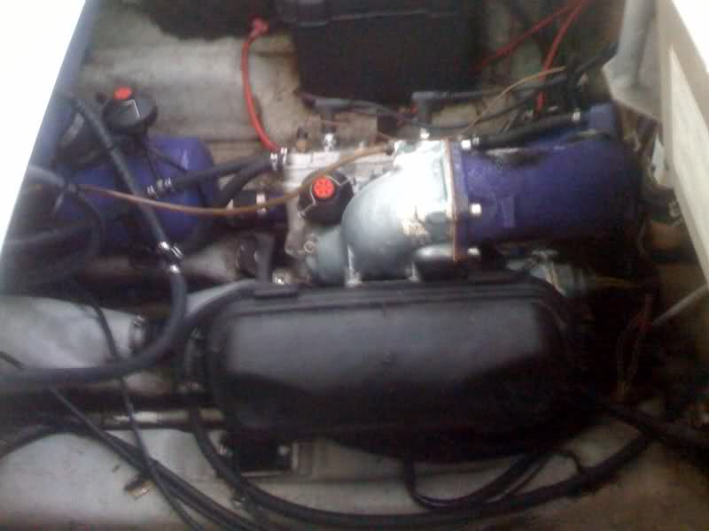

He told me that previous owner did a mod at the exhaust (or whatever it is called..) for better performance (see pic. of the motor I posted) and the boat run a little rich (need to change spark plugs every 8-10hours)
What kind of mod is that ?
Are you sure that isn't a 97 Challenger? It looks just like mine and Snipes. I have never seen a 96, so maybe there were no changes in the design and looks.
I just posted a pic of my 97. It looks exactly like yours.
There is no reason for why they HAD to change the looks, but usually there is at least different decals from year to year.
So it could be 96...
By the way that is a KICKA$$ Boat if you swap out the impeller with a swirl impeller. It will hop out of the hole as good as any other boat i have ever been in, and better than most, even when overloaded.
Mine even had the worn out "SEADOO" on the seats. I took that off with a rag damp with lacquer thinner and just quickly rubbed it out, then washed with soap and water.
