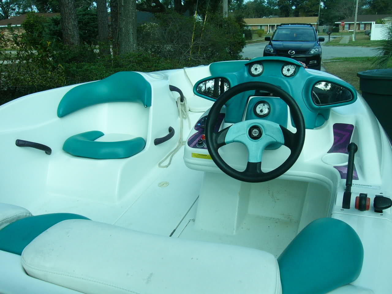

The boat is now sitting in my driveway :hurray:
The guy called me yesterday and told me the starter was working again and he went to test it.
Today, I went there with my with father-in-law and we checked everything.
Compression test showed around 140-150 PSI on both cylinders then we went on a test ride and everything sounded fine.
Guy gave me the brand new starter and all kinds of stuffs.
I think I did good for $2700 :)
Going out for a ride Monday since it's going to be warm and sunny :reddevil:

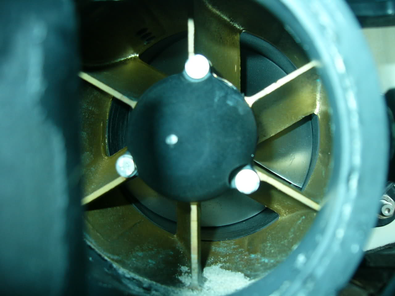

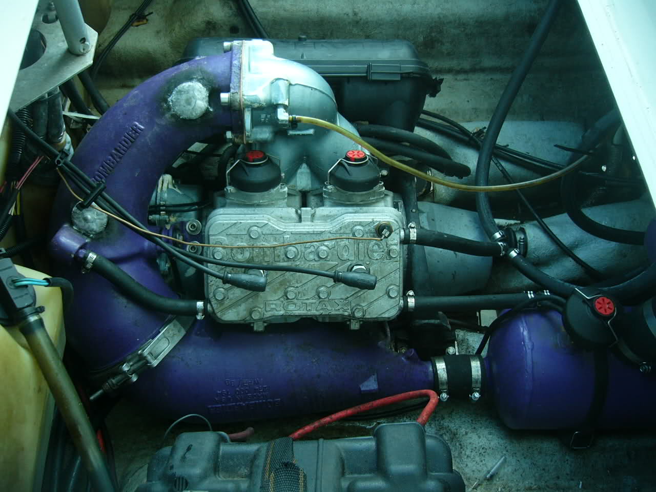

Took it out on the bay today! It was fun ! I love this boat :hurray: . Everything works perfect...not a single drop of oil in the engine compartement.
Really happy with it so far.
Max speed was around 35mph (with me alone on the boat 1/4 tank fuel left).....seems a little "slow".....is that normal ?
Pics (also pic of the impeller...does it look good?):

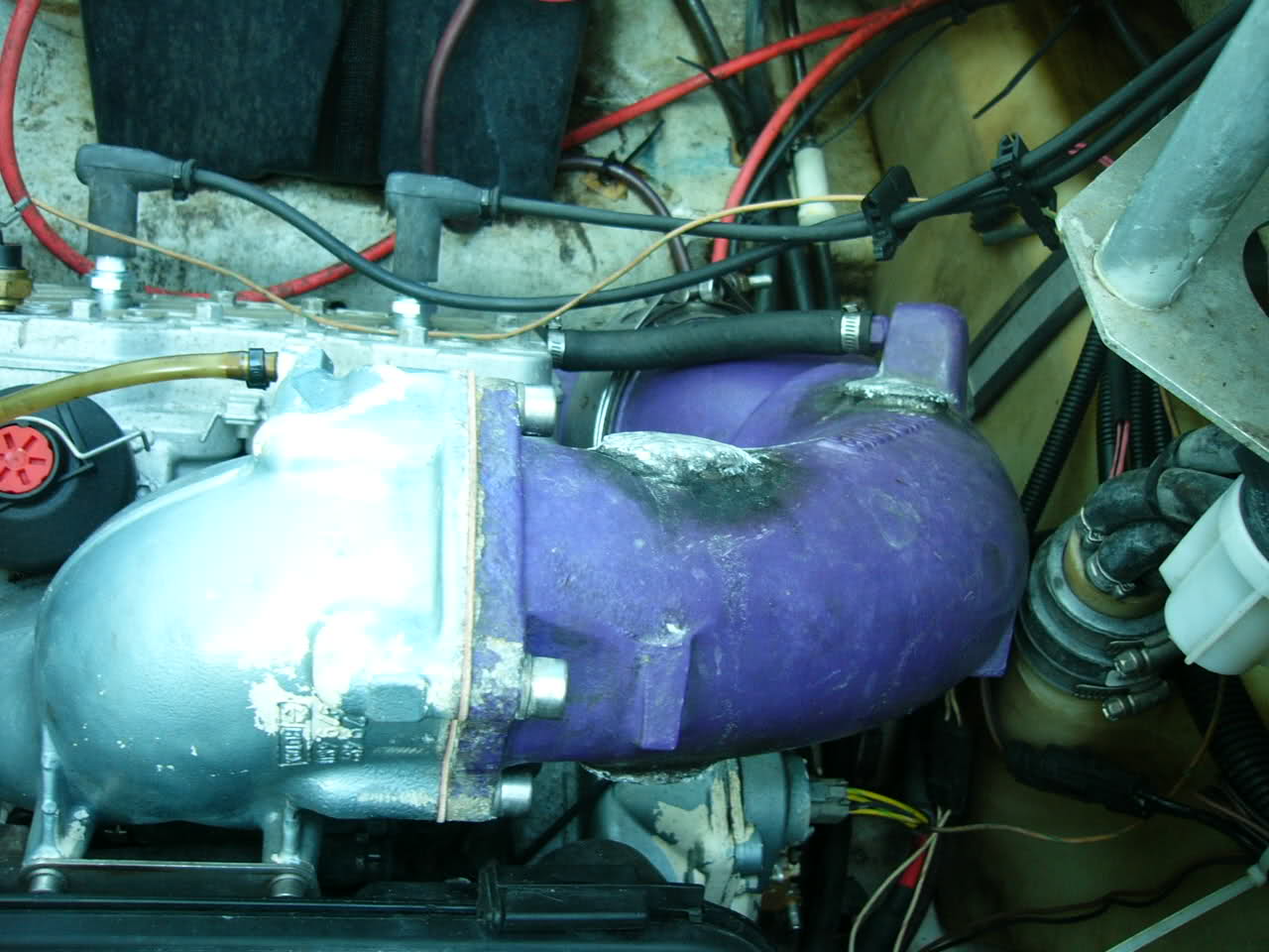

Also what is this mod on the exhaust ? Guy told me it was done to make the boat go faster or more powerfull and that it makes the motor run a little too rich (need to change spark plugs every 8-10 hours)
quit hit'n "enter" button....:rofl:
:hurray:..for dig'n the boat. The last pic of the pump assy, take a look back in there, and with feeler gauge, see if theres more than 1mm/.040 space between the impellor blade and "wear ring". That might be the reason for 35mph. Did the boat seem to rev real easy, but take awhile to plane? The "modified" pipe, is probably where pipe sprung leak, so he "goobered" it up w/ j-b weld, since no water in engine compartment, your good to go there.
If you feel brave, pop the "rave" caps off, and clean the giotines, simple job, just remove cap/latch slow, so spring dont go fly'n.
Anyway...congrats, clean look'n boat.

That engine is a 587. Sea-Doo never offered a 750.
Chester
You think he might be thinking of the 717? It's obvious he's got the 787 in the boat but the next size down is the 85 hp 717.
And if someone's trying to sell you a rebuild for 2K......your gettin ripped!
The exhaust mod could be the one i have read about where they drill out the baffles in the water box to improve flow.
Plugs are cheap, or you could adjust the low and high speed mixture screws in the carbies to get it right.
The jb weld on the core plugs in the tuned pipe will cause corrosion because of the different types of metals, if you get a chance i would remove the pipe and get it welded properly so it lasts longer.
You should see about 45mph with you and half a tank!! wear ring/neoprene seal/7200rpm.
I think 787 engines would be more common than 717's and would keep looking until i found a complete 787 in good condition.Buy a wrecked jet ski they are almost the same.
Mine has those same bung issues in the pipe (in the XP). I drilled, tapped, and ran in a stainless bolt using 2-part epoxy as "locktite", then scuffed up the inside and filled in the hole with the rest of the epoxy to keep the water from eating around the bolt.
I took the XP apart a year later after some SERIOUS use and it all looked just as I had put it in the year before, so it seems to be holding up.
Mine was more of a problem on the bottom where previous owner left salt water sitting in the pipe and it corroded holes into it.

Thanks for the infos. Yes, it rev easy but it took a looong time to plane (with 4 ppl in it....when I was alone in it ,it took less than 10sec).
Also I hear a metallic rattle when flushing the boat... is that an indication of a worn wear ring as well?
Going to check the space between impeller and wear ring.
Rattle when out of water is perfectly normal. You can buy a $15 anti-rattle kit if you do a wear ring swap.
I HIGHLY suggest going for the swirl impeller if you do a wear ring swap. Actually, I encourage you to look into it ANYWAY.
Call Dave at Impros and he will tell you what impeller and what prices. I bought one refurbished (he said it was so like-new that he refused to sell me a new one) and it showed up looking exactly like new. 909-370-4900
Yours sounds like it ran like mine when i got it. It will make an awesome difference.
Cool thanks for the infos ! I'm reassured about this "rattling" sound now. This is my 1st boat so I have a lot to learn...but I'm already hooked :reddevil:
Called the number you gave me...impeller + ring will coste me around $250. Going to order that.It sounds like a good investment. They have a detailed "how to" on the impeller/ring replacement.

Just checked the space between impeller and wear ring and I get 0.035-0.040 max space all around.
