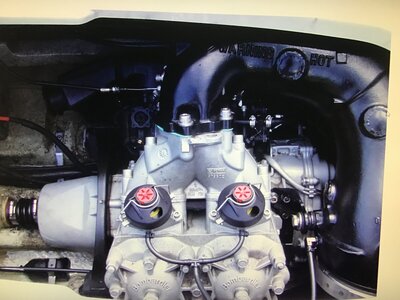

the engine look like the silver engine so im very confused what mix i got lol.

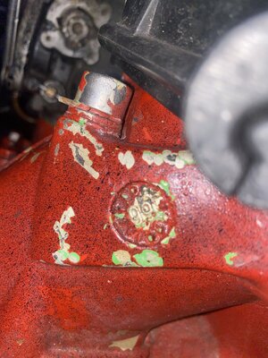

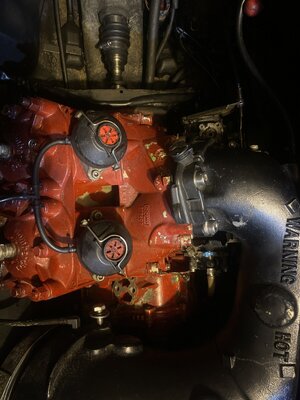

So the “genius” previous owner paint the engine all red but some area paint came off and it’s bare metal so I’m not sure.
I know there is the 1997.5 engine and then the newer ones but even them when u go to partzilla they have on 1998 3 different engine same to 1999.
Look for casting dates..(possibly easiest to find would be on the exhaust manifold
97.5 & 98 are single coil
99 dual coil
Different flywheel magnito
So I checked it it’s 99’
But on partzilla they have gsx limited 5848 and 5849 how I know which is what I got?
