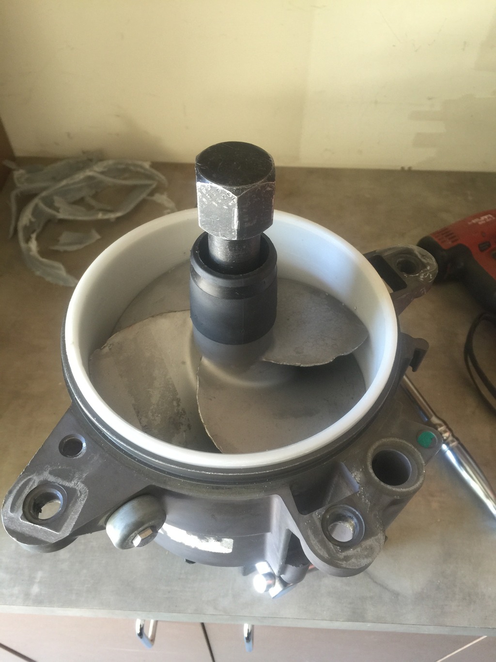

Thanks CoastieJoe, that makes sense. The weather is nice here now and I don't have the time to take the pump out. going to take it to a local mechanic, not the dealership and see what's up. in the meantime will order a impeller removal tool, any recommendations on which one to order?
Name brand is not important. I paid $12 for mine. Have never used it yet. Cheap insurance. LOL

With many mechanical items, there are tricks of the trade. One of them is putting the pump in the freezer for 30-60 min to allow the ring to contract. It then pulls out with no cutting or impeller removal needed. For doing it yourself it is great, but I now see the OP is having a mechanic do the work, so I'd probably get the tool rather than 'pay the man' for the extra hour.

thats all true but some times it works some it doesn't, i also like to check and be familiar with the impeller, bearing and grease in the cone.
you just dont know what other owners have done until you check and see how everthing goes together.

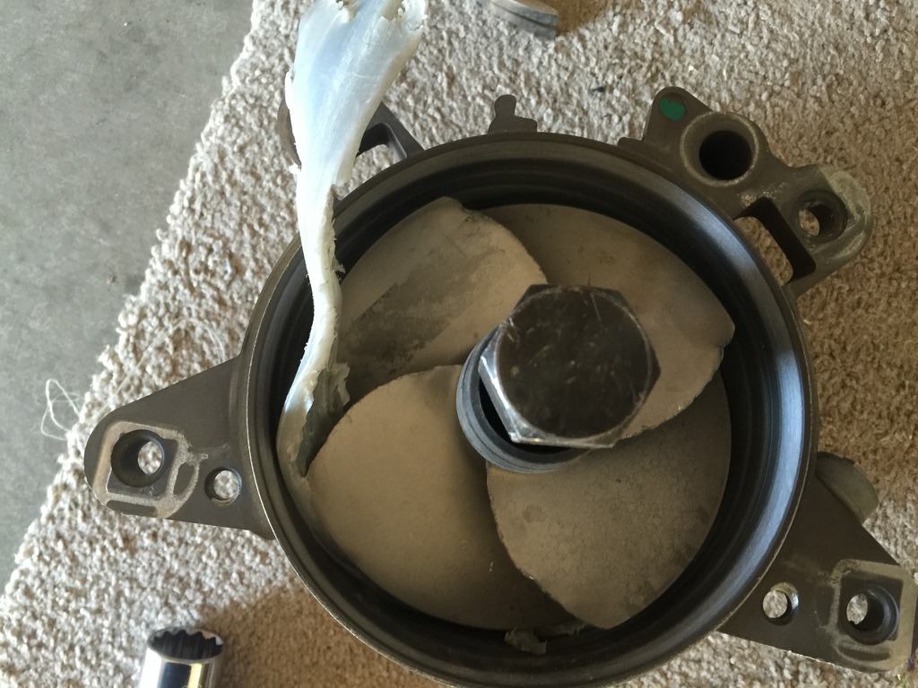

thanks guys for all the posts and information, yes it vibrates, revs high, but does not move fast. got a message from the mechanic that it was a piece of wood that damaged the wear ring.
I have ordered the impeller removal tool, and two wear rings. Having them shipped to a border in Washington state and the next time i head out that way i'll pick them up. i am sure this won't be the last time this happens and then i'll be prepared to do the work myself and hopefully a bit more confident with all your feedback.

Here's the latest update. Picked up the boat, there was a small piece of wood wedged in between the wear ring and the impeller. He gave me the wear ring and i could see the marks on the inside of the ring, oddly, i was expecting the wear ring not to be in one piece as i thought it had to be cut in order for it come out.
I am going to learn from this experience, that cost me $350 Canadian. I have ordered the impeller tool and a couple of replacement wear rings. The mechanic seemed legit, i was referred to him but something has me a bit puzzled. what i had read about in the manuals and online all pointed to removing the jet pump from the back of the boat, and the first step was to remove a cotter pin (and not to reuse it), then take the reverse cable out of the reverse gate and then proceed with removing the jet pump housing. When I took the boat home to park it, i looked at the back of the boat and the same rusted cotter pin was back there. I would like to think there is a good explanation for this, maybe that cable doesn't need to be removed to get the jet pump housing out?

Good to hear it's all fixed, or should be. If he gave you the old ring and its not cut up, its probably because he used his freezer like I mentioned !

Replacing wear ring is fairly easy. I'm pretty sure one these sea doo jet boat is he same as the sea doo jet ski just hat u have 2 and jet ski have one
Must have tools for doing it
A counter mount vise grip
Tool to remove impeller
A set of mechanic socket wrench set
That's my first ski I did took me total of about 5 hrs but maybe 2.5 hrs was going out buying the right tools when I did my 2nd ski took me 1.5 hrs and the dealership wanna charge me 450 to do it
