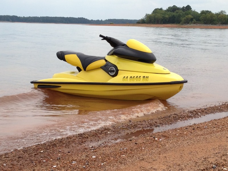

Well, with the v-band clamp preventing me from working on the engine, I've switched my attention back to the body/modifications. I recently got in both the Black Tip mats and the Mline seat cover I mentioned. After another couple of hours buffing, and finally finishing with a wax, here is how she looks.

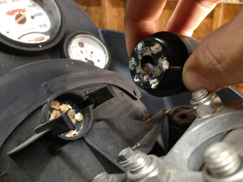

Well last night was a good night for sorting some details. I finally solved the missing beeper issue. After taking the handle bar cover off, I found that another damn dirt-dobber had made its nest up in the speaker hole. He effectively covered every single opening and the larva was just a snoozing up in the speaker. After a good cleaning and a couple smacks from the back of my screw driver, it's back beeping! So, outside starting it, I think I'm all systems are go.
Most definitely...

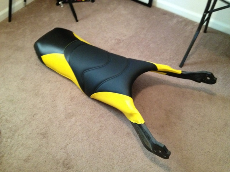

On a side note, I finally found a decent upholstery shop in town (right around the corner conveniently) so the seat cover is in qualified hands. He said he might have it by the weekend; here's hoping.

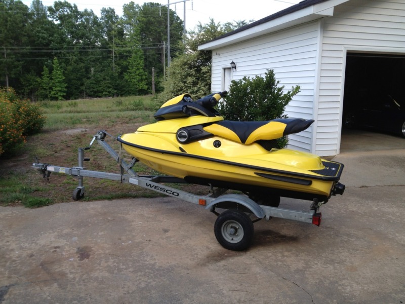

I'm not sure yet. Priority is getting it to the lake by the weekend and all mechanical work. I will get some HID numbers before we go but won't worry about the aesthetic graphics for a minute. I also want to give it a full look with the seat on. It may provide enough flash to go without it. I'll post pictures tonight.
