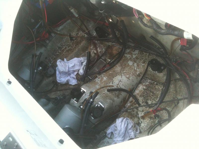

If you'd like to see the results of Super clean check my XP thread. Plenty of pics to see the results. DO NOT get it on the yellow unless you wash it off right away. I put it in a spray bottle. You'll read the process I use.

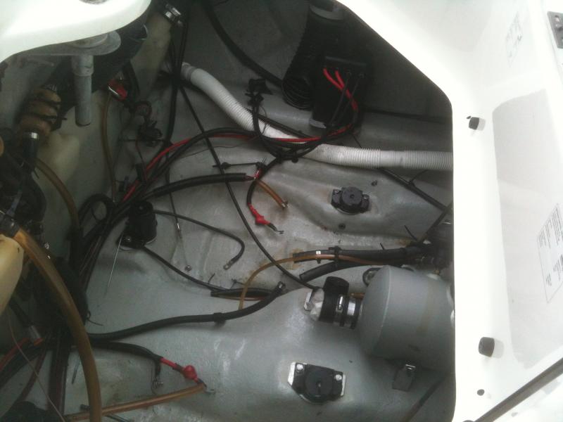

Here's what super clean will do. This is NO scrubbing... and garden hose pressure. (2 applications. Once to get the bulk, and the second for what you missed)
