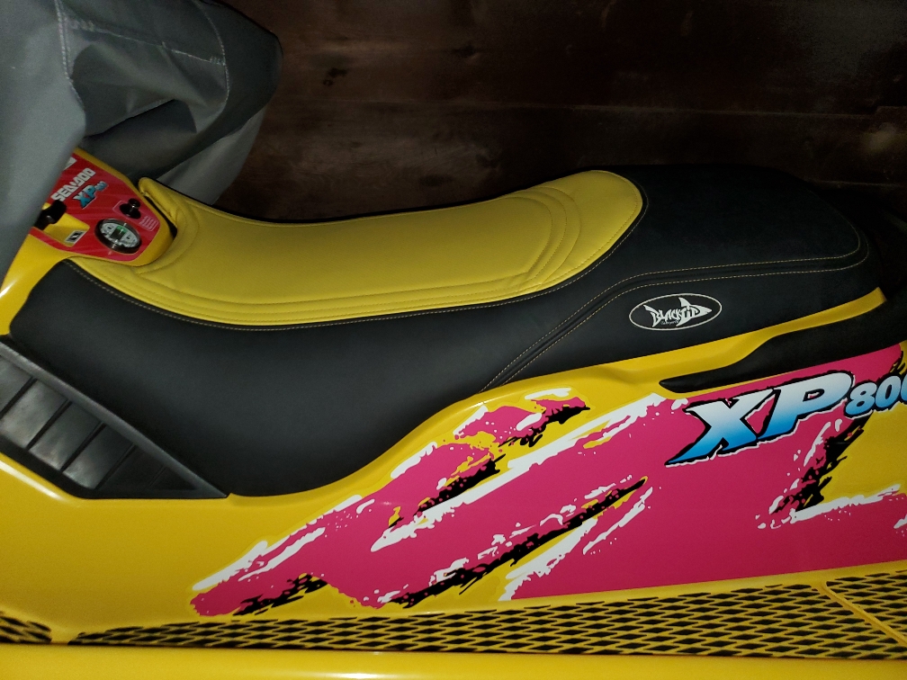

Seat covers..... Jet trim is probably hands down the best you'll get. The Black tip premium, second, they actually put foam on the underside like jet trim, really nice cover. Then you have just regular vinyl that's patterned or just a single piece of vinyl. If you wait till black Friday, black tip usually has a 50% of sale. That's where I got my one I pictured. I picked the colors and material. It's black suede and yellow carbon fiber vinyl with yellow thread. It's pretty damn nice.

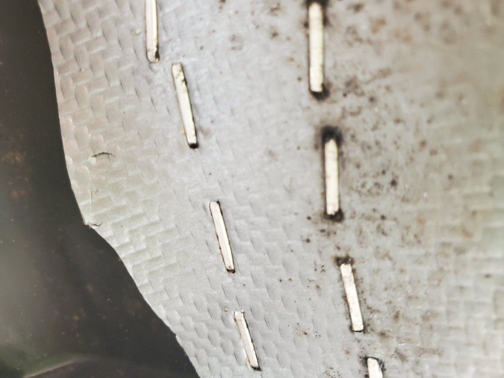

Now, staples. Everyone is gonna say stainless. YES. Personally, I use the T-50 3/8" from home depot. Others will say, Oh, you have to use Monel stainless staples. Umm, no. I ride in fresh and salt water I've NEVER had the staples rust. Ironically, I have a seat from a 99SPX with the original cover and staples and there is a section with rust staples, Monel staples, from the factory. The one picture of the gray carbon fiber seat material is from my HX. I think I finished that 5 years ago ... No rust on those staples.
