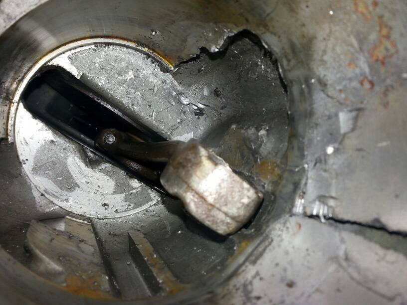

uggghhh. One piston disintegrated and the wrist pin took out part of a sleeve at the ports and also part of the block at that part. I feel sick. Since I have a complete (but broken motor) 210hp , is there another 2.5l merc that i can drop my crank (provided that it is good) in and be back in business?
I brought mine back from this. $900 at the machine shop and $150 for a new sleeve and i was back in business.
holy crap. I have NEVER seen so much destruction and a piston completely gone like that... I'm doing a rebuild on a second 240 efi for my wifes boat. did mine last season and they are pretty easy to do. dr Honda is a wealth of knowledge on these as well as others. theres many posts on here to help too. both the wife and I will have our own 20' sea doo challenger 2000 sitting on the dock this up coming season. I just ordered new complete traction mat sets for the both of them on black Friday. 2 sets for the price of 1. cant beat that with a stick ...
I just pulled my 240 out of my 01 challenger.. its got a partially melted piston so yea keep a tally of the cost for us ! [emoji1417]
looks like fun! i hope to pull my engine next Sunday. I'm already having a hard time waiting for spring - may have to fix it in January, then break it in around March if the river is not frozen.
That looks as bad as my engine. You can pull the block back, and weld it. Then machine it... then sleeve it. BUT... most shops won't deal with that.
