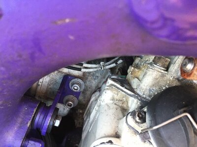

Does this look correct?
burtshaver2021
Premium Member
Premium Member
This is a 787 motor in a 96 XP. I noticed that on both sides of where the exhaust manifold bolts to cylinders it looks like there is room for another bolt. Is this correct or is something missing from this machine?
Thank you, I will have a look at the manual later, just found it weird to have an empty bolt hole on each side of the exhaust manifold. I could also have a look at one of my 787 GSX’s. I’m considering purchasing a 96 XP, that could need a lot of work.
Empty bolt holes are correct.
Tempo "Gray" fuel lines and original oil lines are not correct and asking for a blown up engine.
