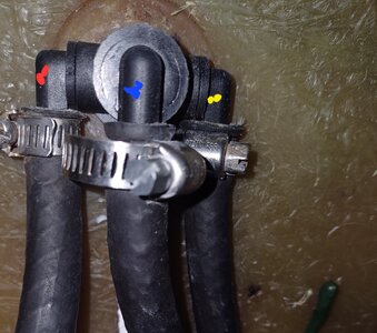

Hi Burt
Let me see if I have wired my fuel pipes correctly lol
As per below the red dot goes to RES on baffle.
Blue goes directly to the fuel filter showing the arrow in the other arrow showing out goes to the carb that has a arrow showing in.
The yellow goes to ON the baffle
The is a VENTon the baffle that goes into a t piece which vents on either side of the tank .
The other nipple of the baffle can't see the name this also goes to the carb with arrow showing out.
There middle nipple on the carb pulse ,this connects directly a short distance over on the motor left of the rotary valve cover

That’s a good idea to make sure your fuel lines are on correctly. Your fuel selector looks different than mine, on mine, everything is embossed ON RES VENT RET but you have to look closely.
Hi Burt
That is the correct installation.
