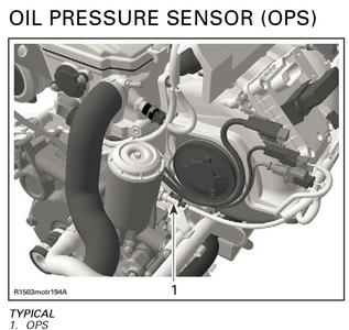

I have a 2012 GTI130SE that randomly throws a Check Engine warning. I had it scanned, nothing. It doesn't go into limp mode and top end isn't affected. It just randomly beeps for 5 seconds and the check engine light comes then less than a minute later, the check engine light turns off like nothing happened. Oil level seems fine, I was thinking it may be the oil pressure sensor since I have read threads about them possibly being defective. Any other thought or ideas?

It is not expensive but if in same location as my 2005 RXT, it is not easy to get at.
I ended up pulling the intake manifold.
Suggest you look at it before hand so you can order gaskets for the intake if you have to remove it.
Be careful you do not drop the gasket in the end of the OPS connector when you pull it off as I did.
You will have remove the hoses that are in the way,,,,but will not need to remove the manifold…be careful removing the electrical plug,,,,the retaining clip breaks easily.
