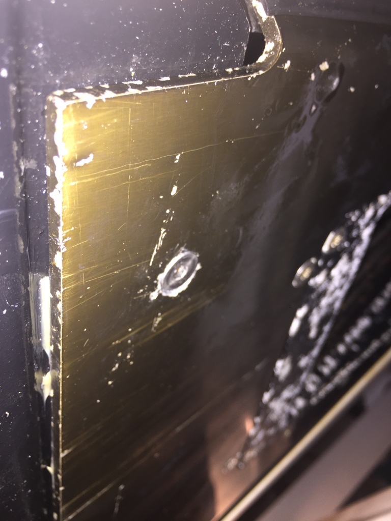

Challenger extended ride plate
Well- just lowered the plate a good inch- took it for a ride............. fixed. Cheers mate! :)
Sorry, when I originally responded, those pics had not been posted? Anyways, yes that is most certainly the extended ride plate! I'm very surprised that you are experiencing porpoising. I would examine all of the bolts that are holding it on, to see if they are loose or broken? If in fact they are good, then maybe you need to adjust the back of it to be a bit lower in the water?
Another possibility is that there is something being used as a ballast in the engine compartment or rear storage that puts extra weight at the rear... that will induce porpoising even with the ride plate!
That ballast idea, brings up a good question... when you were out in the boat and experiencing a lot of porpoising... did you have passengers that were all sitting in the back seats? If that was the case, then you may just need to move your guests around to better balance the load.

No ballast- i was alone in the boat. The back of the boat was empty -I even removed the trunk floor. Half a tank of gas. But dropping the plate down another inch made all the difference in the world. Now I just have to figure out why it pulls to the left so much. The plate is level so I'm assuming it's linkage with the jet nozzle.
Great news! One thing with these boats is that between the driver, the battery, tool bin, helm electronics ... there is quite a bit of weight on the starboard side. So it will pull that way! You can certainly adjust the steering cable to get it relatively straight, but as with any boat there are many factors that cause it to drift one way or the other, not to mention the shear fact that the water propulsion is spinning and it alone will have that effect. So it's all about getting weight balanced, steering cable as close as you can and you should be good. The ride plate can also help by adjusting one side lower will help steer.
Try raising the left bolt one full turn and retighten the jamb nut. One turn solved my pulling issues. Basically you want to lower the side you want to pull more towards. In your case either lower the right or raise the left.

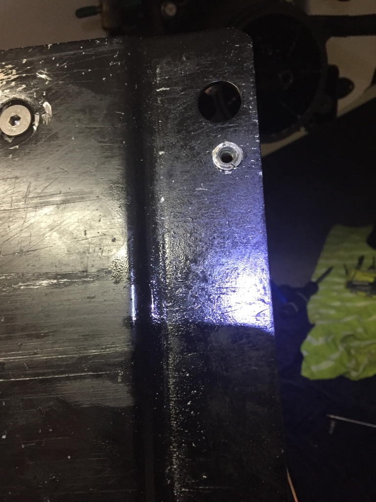

I'm chiming in hopefully with some helpful info. I too had to drill out the screws in the ride plate and I was able to seat a stainless steel nylon lock flange nut in the ride plate. I made the hole in the ride plate slightly larger and tapped the flange nut in with a hammer. Then I used new slightly longer screws that would extended into the hole in the housing caused by drilling and tapping at the broken screw. Held perfect with no issue. I also purchased slightly longer bolts to drop the ride plate a little lower and was able to stop the porpoisesing .
I think it is important to note that using a higher grade bolt all the way around is very important. I pulled my ride plate again this morning as I am taking it in for winterization. I come to find that 3 of the four are shot. One of the Torx up front was all that was holding it. The other Torx worked it's way out, and the two bolts in the rear were either sheered off, or sheered when I tried to remove it.
The stress on those bolts has got to be great. I am 90% sure that I will need to drill and fill the front hole again. And I can only hope I can get the rear sheered one out.
Please don't take this the wrong way, as I am not badmouthing the plate. It does exactly what we are looking for it to do. But I can't more strongly recommend upgrading the hardware, and checking it annually.

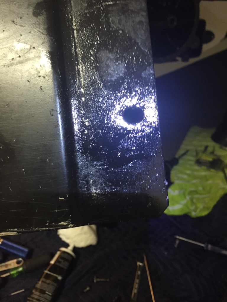

I just attached mine and it works great(Thanks Aquaman/Mark?- requested it Sunday, Mark called fabricator Monday, fabricator produced, I payed and Mark shipped on Thursday and I received the plate on Saturday- awesome turnaround time). One other option for removing the phillps head screws after trying the torch with the impact driver , was to place the impact driver phillips head bit in my socket/wrench and then jacking up and then lowering the boat onto my wrench that was resting on a block of wood with the bit inserted into the head of the screw. The wrench and bit were then sandwiched between the boat and block of wood, thereby preventing the bit from spinning out while rotating the handle. I loosened a quarter turn and then tightened working back and forth. One screw came out and I snapped the head off of the other. I then removed the star/torx bit screws easily/no resistance , removed the plate and used the double nut method previously mentioned to remove the remainder of the broken screw. Prior to all this I applied PB blaster to the screw from the open top of the thru hole. Hope this helps.
