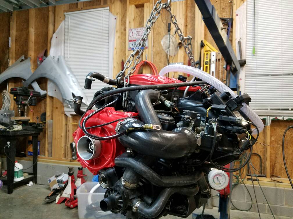

Got the motor all assembled last night. Compression was 170 and exactly the same on each cyl [emoji3]

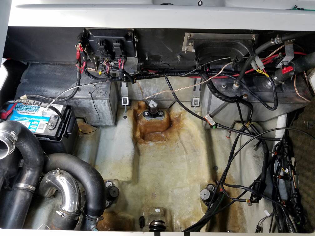

Cleaned the few oil spills and debris from the engine bay

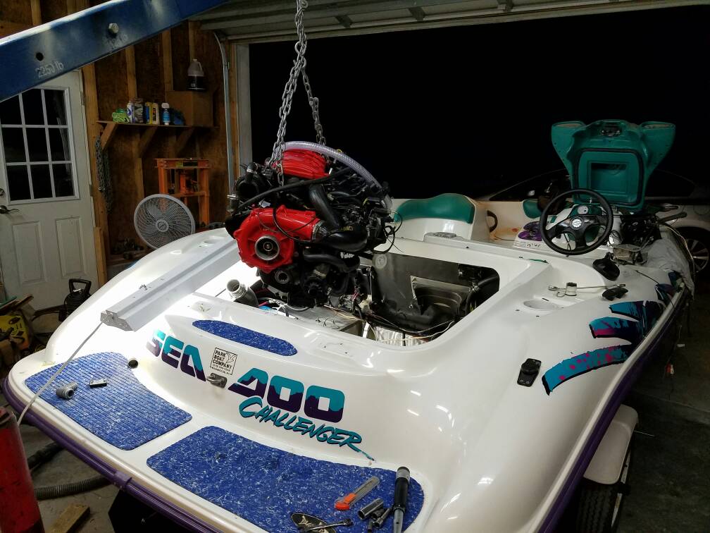

And in she went
Took a while again to re-align the motor. I pushed it as far fwd as I could. I read a bunch of forum threads where guys were having their thrust washers chewed up from the motor flexing back during choppy conditions. Anyway, I'm ready to start adding oil again and priming the system. I have a makeshift pressure gauge to see what the oil pressure will be. Will the engine not freak out of its not getting an oil pressure reading? I hear it's quite a challenge to clear these codes
