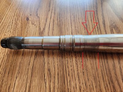

DRIVESHAFT wear question: I am replacing worn out Carbon Ring (the whole kit), but is this amount of driveshaft wear okay?
2013SeaDoo GTR 215 80-hours.
That part of the shaft is tapered as it is the part that is in the bellow. You can see where the hat was with the line, this would be up against the carbon seal. The carbon seal seals on the face with the hat along with the o-rings on the shaft. They are machining marks just like the on other parts of the shaft.
The driveshaft looks great to me...
Again, the driveshaft should have nothing to contact it at that point of the shaft.
