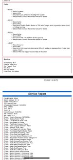

Anybody can help with these codes . P062C, P0122 , P0222 , U0457. Seadoo gtx 230. Help!

2019 Seadoo gtx 230. It gives a start for 1 second then cuts off—no check engine even with Candoo apart from the codes I listed.

The tps codes went away after I changed the battery. Guess it came because of low Battery. Just the speed sensor code is there now
Okay, so my first post seems like good advice. Your speed is measured by gps inside the cluster, not a speed sensor in the paddle wheel like the older models. Pretty common to have gps signal go out momentarily and throw that code so it will be just occurred and not active.
