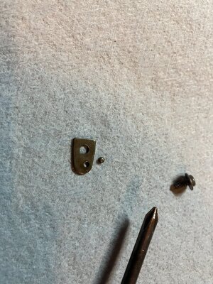

I might be waiting for a part anyway. As I was taking the old check valves off the metering blocks, I sheard the nipple of the little plate.(or it already was) as when I turned the screw the plate and valve spun.
What is this part called and where could I get one? I couldn’t find it on osd
Or what do you think, can I just line it up and snug it down?
Never seen one of those break.
Ebay maybe? Westside Powersports Seadoo?
Boy it’s not easy up here in Bombardièr land.
Finally found one that’s not $20+ usd for shipping but won’t be here for 2 weeks.
