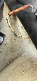

Hey guys, little help needed. Buddy gave me his 1997 XP that had sat for quite some time and was winterized before storage. The MPEM was sent off and made sure it worked, the original key paired and tested and an extra key paired and tested. Brand new battery 12.5v tested. New start button and new beeper. Originally I couldn't get anything to work, no beeps, no crank. I tested the starter solenoid and jumped it via a screwdriver, cranked over. Still no crank with start button. Once I disconnected VTS, I was able to crank via the start button. Eventually I was able to figure out that the beeper wiring was corroded so I replaced it, which then got the two chirps on putting the key in. Sweet.
Now out of the blue I no longer can get the ski to crank with the start button (As I was now going to check spark). As well as I cannot get it to crank via jumping the solenoid now either. I still get two chips when putting the key in, but if you hit the start button you hear a click, and then if you hit the button again it just gives a 2 second beep every time you hit it. Any suggestion on where to go from here?

So I went ahead and took all of the connections off and scrubbed them down. Decent corrosion on the copper bolt for the solenoid and the ground for battery. everything seems to be cranking like normal now when putting key in. 2 chirps. Then cranks the starter. However now that I’ve rectfied that on to the next. No spark. What would you suggest to go to next?
