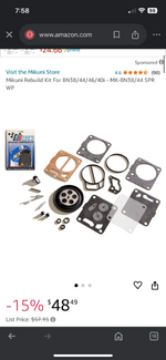

If pulling the choke masked it run better then you either have an air leak somewhere or the fuel is being restricted. Did you ever end up running a fuel line directly from the fuel tank to the carb to eliminate the fuel selector valve and filter from the equation? Also I know you said genuine mikuni but I’m interested to know where you bought the kit from? I find ebay and amazon can be deceptive In their advertising to lead you to believe its genuine Mikuni when it’s not.

I haven’t ran a line straight from the tank to the carb yet. I believe the rebuild kit was from Bay Area power sports and all the parts fit perfectly.
This is what I found at Bay Area powersports for your machine, the kit is Winderosa, this very well could be your problem. Although they appear to fit correctly the tolerances are off
