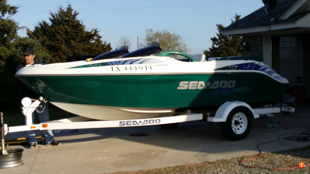

Doing needles and seats next weekend. ... got it buffed and polished today
Sent from my SAMSUNG-SM-N900A using Tapatalk
3m heavy duty polishing compound and meguirs finishing polish. Buffer and grinder. Bought a buffing wheel for the grinder... still need a coat of wax
Going to remove the decals but that isn't going to be a easy task... im still trying to find the best way to do it
