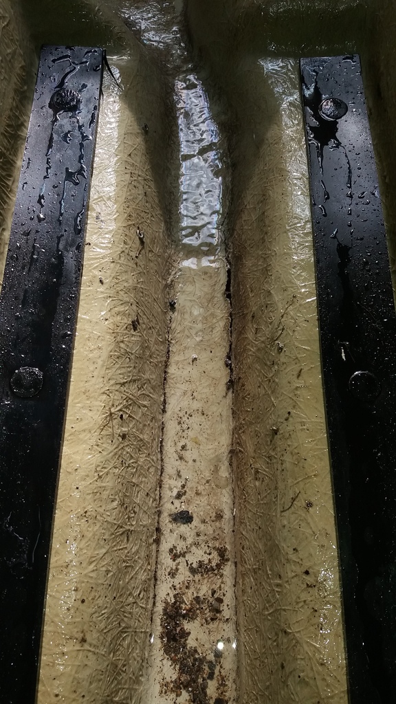

This is the good part. The hull is completely stripped and as clean as its going to get. I am now able to really asses the damage.

Now its time for the big decision. How to move forward from here. The damage is extensive but repairable. There are no hulls listed nearby on craigslist or ebay. The one that was offered to me is not ready for pick-up and we dont have a definite time for it to be ready. The top end is at groupK now and has a 6-8 week completion date. That means I have 6-8 weeks to repair or replace this hull.
I think 2 layers of glass on the inside under the gas tank will give me a good backbone for the repair. Then flip it over and do the best I can to make a stucturally sound repair. Notice I specify structure and not cosmetic. I do not expect to get a factory finish on this repair. I plan to get it close, spray it with a fresh layer of gelcoat and never look at the bottom again.
If you are of the opinion it is not worth fixing please point me in the direction of a replacement hull. Leads are welcome. But I am not parting this ski out.
The issue is that this is a two piece hull. The inner hull you are seeing is not the back side of the outer hull with the huge split in it, it is just an inner liner. To do it correctly you are going to have to cut out the inner hull above the big bottom crack then glass the bottom from the inside and outside, then rebuild the inner area.
Don't forget there is also foam between the two for flotation and if it is wet when you get to it from cutting the inner hull you might have to abandon this hull all together. As others have warned if this inner foam is saturated with water it will never dry and the hull will be too heavy to bother with moving forward.
If it were mine I would stat cutting out the inner hull to see the extent of the damage and water issues with the foam then.......
1. Patch the bottom from the inside then the outside laying new layers of woven glass cloth and epoxy resin.
2. Pour in closed cell expanding foam to refill the void between the inner and outer hulls.
3. Reglass the inner hull again using woven glass and epoxy resin.
4. Gelcoat the bottom.
It is a lot of work, time and money but it can be done. But as others have said a good donor hull is so much easier.
Here you go, this guy had the right idea. You have more than 11 hours of work to make it solid. Go get that other hull, you can thank me later.

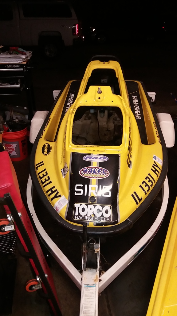

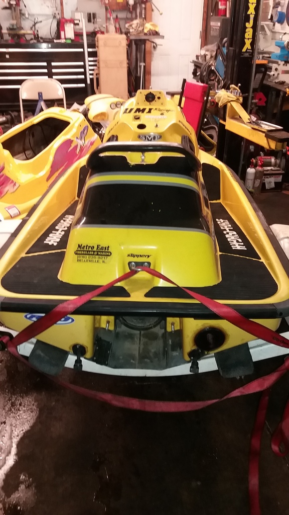

What are the odds. Right after posting I checked craigslist again. This former race hull was up for sale only 20 mins from my house. So I went and bought it. Now I have a new set of problems. This is definately not a stock hull. Extra drain plugs and gauge holes. Ill do a more in depth assesment over the weekend. There is some minor spiderwebbing in the gelcoat in places and a few chips but nothing like that old hull. Maybe instead of a sleeper project this leans more towards prostock.

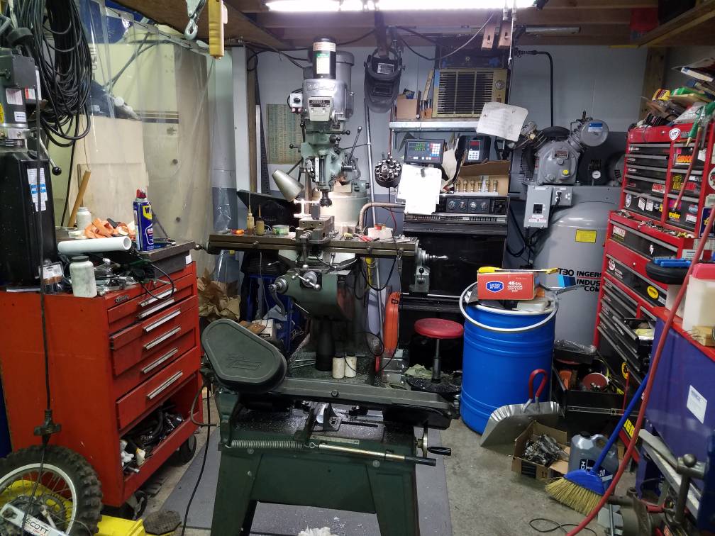

I see 2 Lathes and a mini mill just screaming for a CNC conversion in the back ground and either a plasma cutter or Miller Tig too. Oh, and you're a car guy. So, you won me over already :D
I am a machines guy. If it has moving parts I want to take it apart and hopefully get it back together.
CNC is in the plans. I am actually working on an advanced manufacturing degree now, the conversions will follow. Machining is tough to learn on your own, so at 38 years old I go to class in my spare time to hone my hobby.
I do have a plasma torch. But the combo you see there is a 110v mig under a 220v tig/mig multifunction on a homemade cart. Working a building my first road racing cage in a 97 dodge neon for Chumpcar or Lemons.
New Hull?

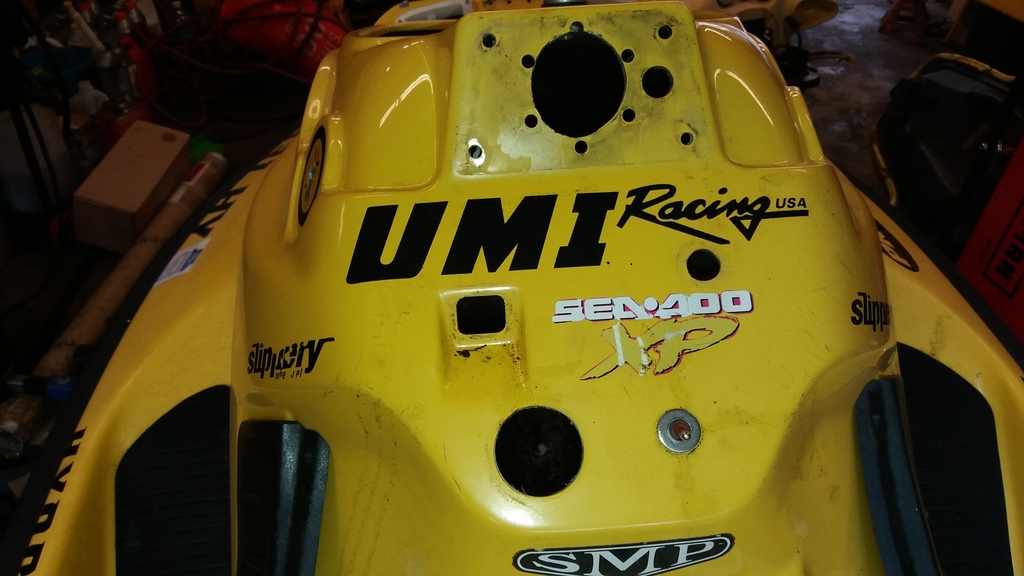

Drilled for an umi system and extra gauges/switches

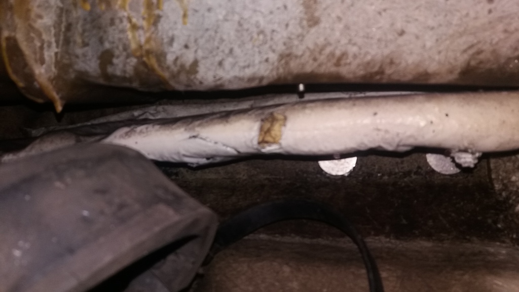

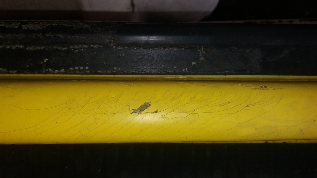

gelcoat damage on rails. There are complete chips on the underside of the hull.

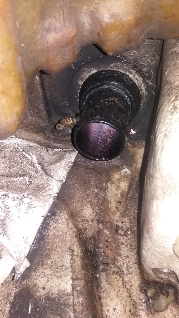

tapped exhust
foam removed from sponson mounting area
This hull would make a super cool "race replica" build. Like my 1st motorcyle, cbr "smokin joe's". I changed the gearing and added Ohlins shocks and that little 600 was a blast in the city. Top end speed is super overrated. Ill take low end grunt and midrange any day.
Kind of a detuned racer for "agressive" recreation. Great handler with some added acceleration.
After talking to the wife I think its a good idea to have a good looking boat, but not a pristine resto, I dont want to be mad if she (or anyone else that ends up using it) chips the gelcoat or doesnt put the cover back on it, etc..( god knows shes chipped and scratched every car/truck I have bought).
So the questions are
Should I be concerned with the spiderwebbing? I there an easy patch that would avoid grinding and gelcoating?
What about missing foam around sponson mounting area?
Should I buy a used umi system and embrace the extras holes already drilled? (saw one for about $400 on ebay)
And last but not least. Still planing to head to MI to pick up a factory hull that I pray just needs a good buff job. I really want a factory look. If everything works out I will build on the factory hull for this year, and build a fake "racer" for next year. The only problem with that is I would need a 2 place trailer........
