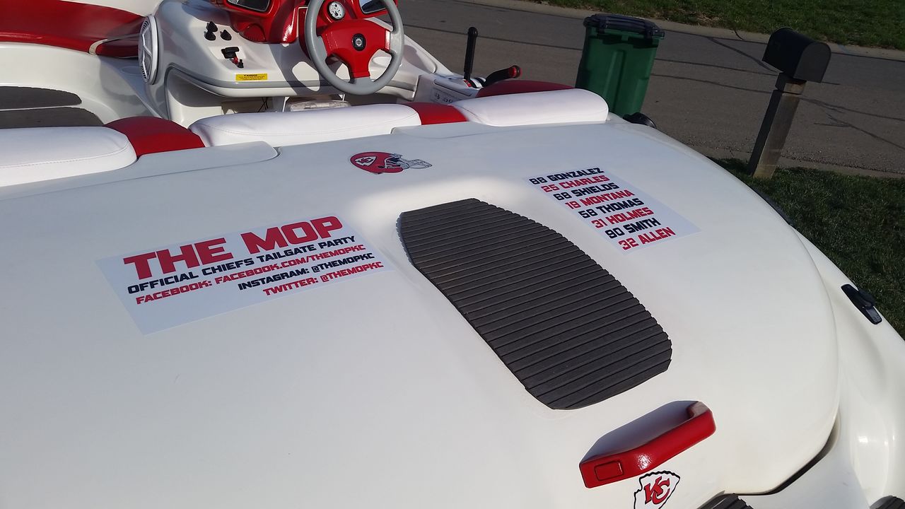

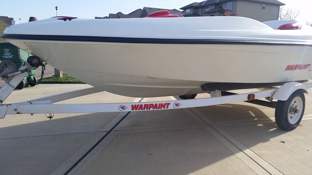

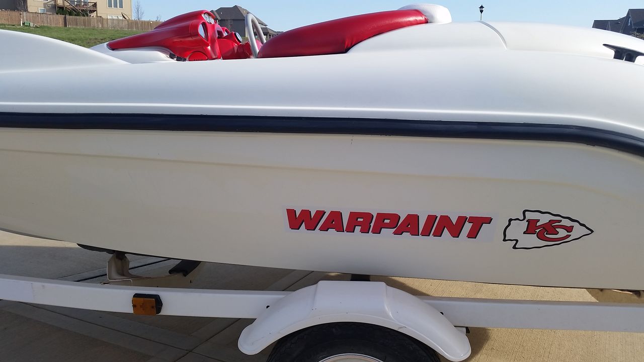

Here's a screen capture of my decal design thus far. I have an entire 54" x 60" sheet of vinyl to work with so I'm trying to strategically place the decals on it so I can get as many on the sheet as possible. Don't want decal overkill on the boat though. Might design a few decals for the camper, maybe one for the truck. So far got the name of the boat on the trailer decals and designed for sides of the hull. Got links to the tailgate's facebook twitter and instagram pages, as well as a memorial list of some of my favorite Chiefs. If you've ever been to arrowhead stadium there is KC Chief hall of fame members on display inside the stadium. Kind of bringing an element of the stadium design and tying it in to the boat. Those decals will go on the back. I used just the right amount of heat with the heat gun that fortunately some of the old decals on the boat would start to come up in one piece. I tried taking the seadoo stickers off of the trailer... It's a no go. It comes off about 1/16th of an inch at a time. I decided screw it, I'm putting new trailer stickers right over the top of the old ones. If anyone wants to design new trailer decals the size of them on my seadoo trailer is 5ft long by 2.5" tall.

Just gave the boat a good polish yesterday because it was gorgeous outside. I used 3m finesse it II with a machine polisher. It worked unbelievably well. I know that 3m finesse it II is really expensive. Fortunately my buddy let me use some of his. At the beginning of the day I had a corse, off white, flat boat. By the end of the day I could see myself in the gloss. I added some more decals and I have a few other custom ones I am going to add as soon as I get my vinyl sheet printed. Fortunately a couple of the decals came up and could be moved cause I placed a couple terribly the first try. Once I get those custom decals on I am going to wax it, put the new solas impeller in, send the wiring through the hull for my GPS and it will be ready for the water. It needs a new battery too :(

Got my decal sheet back from the printer and put all the decals on. I'm extremely happy with how this boat turned out. Now the excitement is lingering for my performance upgrades. My impeller and wear ring are sitting in the garage ready to be installed. My buddy/mechanic is almost done working on a Nissan Z then I'm next in line. Im anxious to see the difference in planing with weight and hoping for no cavitation. Still have to buy a new battery and wire my GPS. I am started on my camper project too. My flooring is in and my day bed/storage area is built. I am only about a quarter of the way done if that. I have to install my entertainment center, put the window unit in, finish the kitchen/ backsplash, paint everything, there is lots to do. I did just clear my lot and mow it yesterday. Waiting on gravel to come. Going to be a great summer. Here's some boat pics:

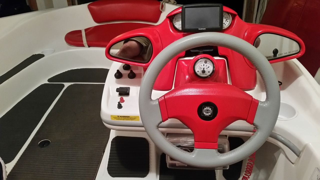

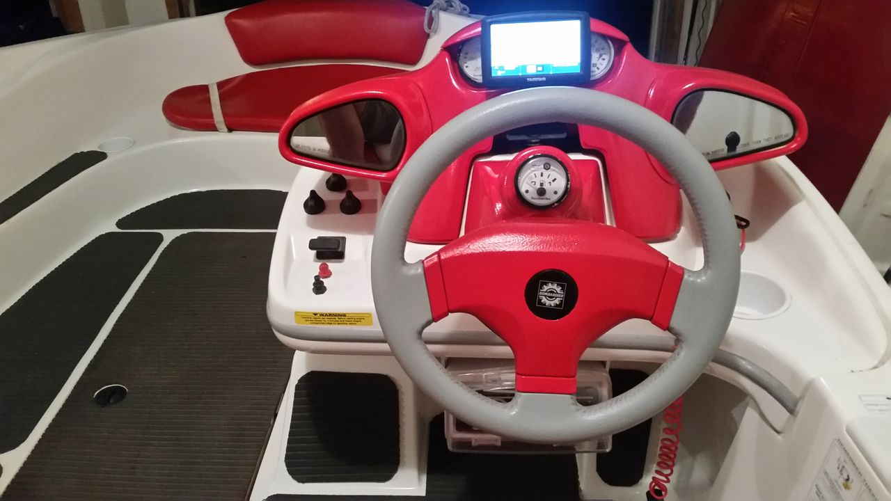

Here's some pictures of the "before and after". The stock 90's colors is how it looked when my buddy Brad bought it. He was going with that orange and black theme when I bought it from him. Then as it sits today.
