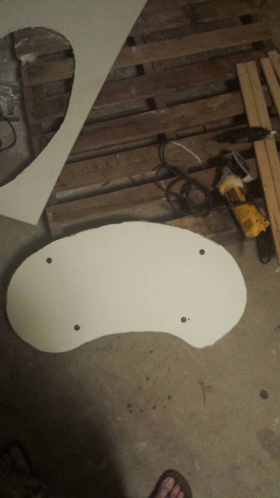

Had a hell of a time trying to get a markup of the bow seat. The marine grade plastic I ordered for the seat came with a big clear sticky on the side for it's label, so I used this to retrace the shape and drill holes. Once I had a rough....and I mean rough!...outline traced on the plastic, I started cutting. Began with skill saw and a dremel, it was taking too long so I switched to my angle grinder lol a few hiccups later and I have my base. It's a little lumpy and misshapen but it works. Now I just need foam and vinyl. Any suggestions on color? White green or purple
With skill saw and dremel
Finished product with plastic "tree" screws in
You'll probably be okay with the shape once you wrap it with foam, but if you really want, you can smooth the plastic shape out with a grinder/flapdisk or even a sanding block. Just be careful with the grinder, they're hungry for that soft polymer!
Yeah I got a little too eager with the grinder trying to round it off, definitely loves to eat. I think it'll work find once wrapped like you said. Picking up marine vinyl and foam tomorrow.

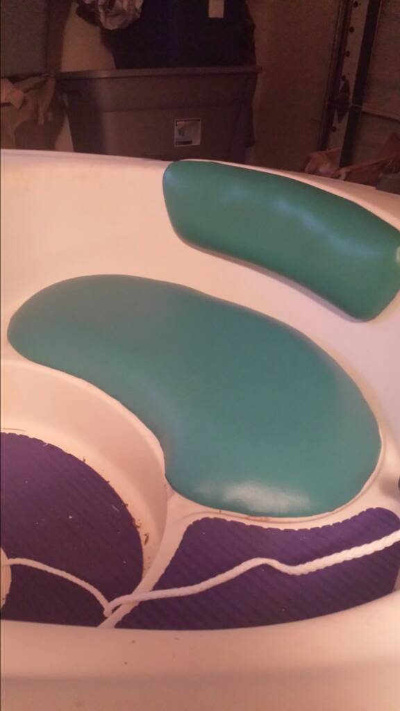

Wrapped it today. A little ripply up front but overall I'm happy with it. Now I just need to paint it with vinyl spray, they only had this teal color at the store
I would, it matches better than purple would, and you have the peace of mind that people aren't going to dye their bathing suits when they ride in your boat
