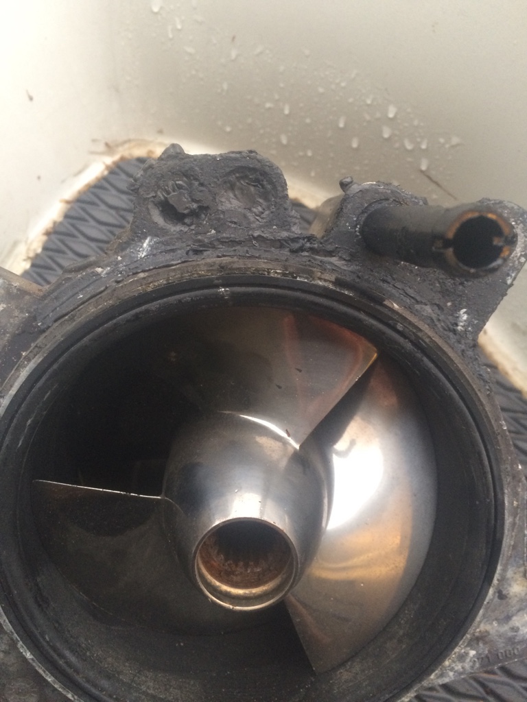

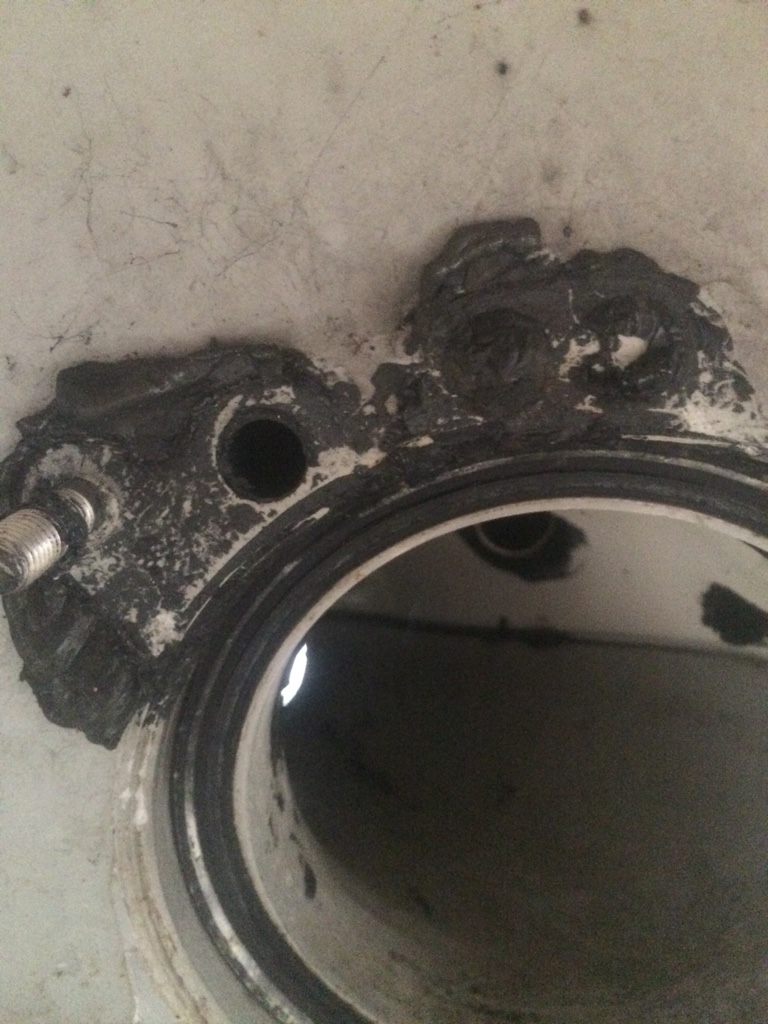

Good thing I pulled this pump off to pull engine would have overheated real fast with water inlets clogged with silicone!
I'm pretty sure that the 2 you are looking at aren't used in the boat. The big, 3/8 is used for the cooling system. One of the smaller ones are used for bailer's on a ski. That's a lot of goop on there. No reason for that much. They must have charged by the tube.

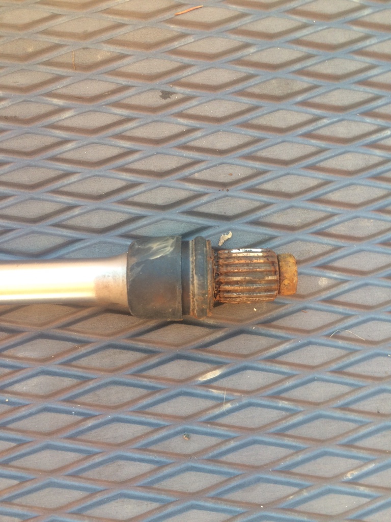

You will need some new boots for the impellers. Also spend the cash for the driveshaft buttons if they aren't there.
The boot should keep the water out of the splined area of the impeller. Used grease when you put it back together
What boots are you talking about? Also do they sell them as a kit. The drive shaft came out of the right side stuck in the impeller. The left side is stuck in the boat. I'm trying to save as much money as I can but want it reliable. Kinda of an oxymoron I know lol.

There's rubber boot, or grommet, that goes into the opening of the impeller. The little recess in the opening of the impeller takes, and locates the boot. The driveshaft slides through it. It seals the splines from the water.

Many people agree silicone (whale snot) doesn't belong on a boat. I know I hate seeing or using it but in some cases it's a requirement. At least you can still take the parts off, unlike some other tenacious marine sealers that require dynamite.
Went back out and looked and the cone was stuck to the drive shaft. Also the bumper is there all just needs cleaned real good and some lube. I will be tearing down pumps to check bearings and repaint housings.

Second the ports plugged up on your jet pump are not water inlets they are used for a siphon bilge system on the Seadoo skis, the boats do not have siphon bilges so the ports are sealed off with silicone.
