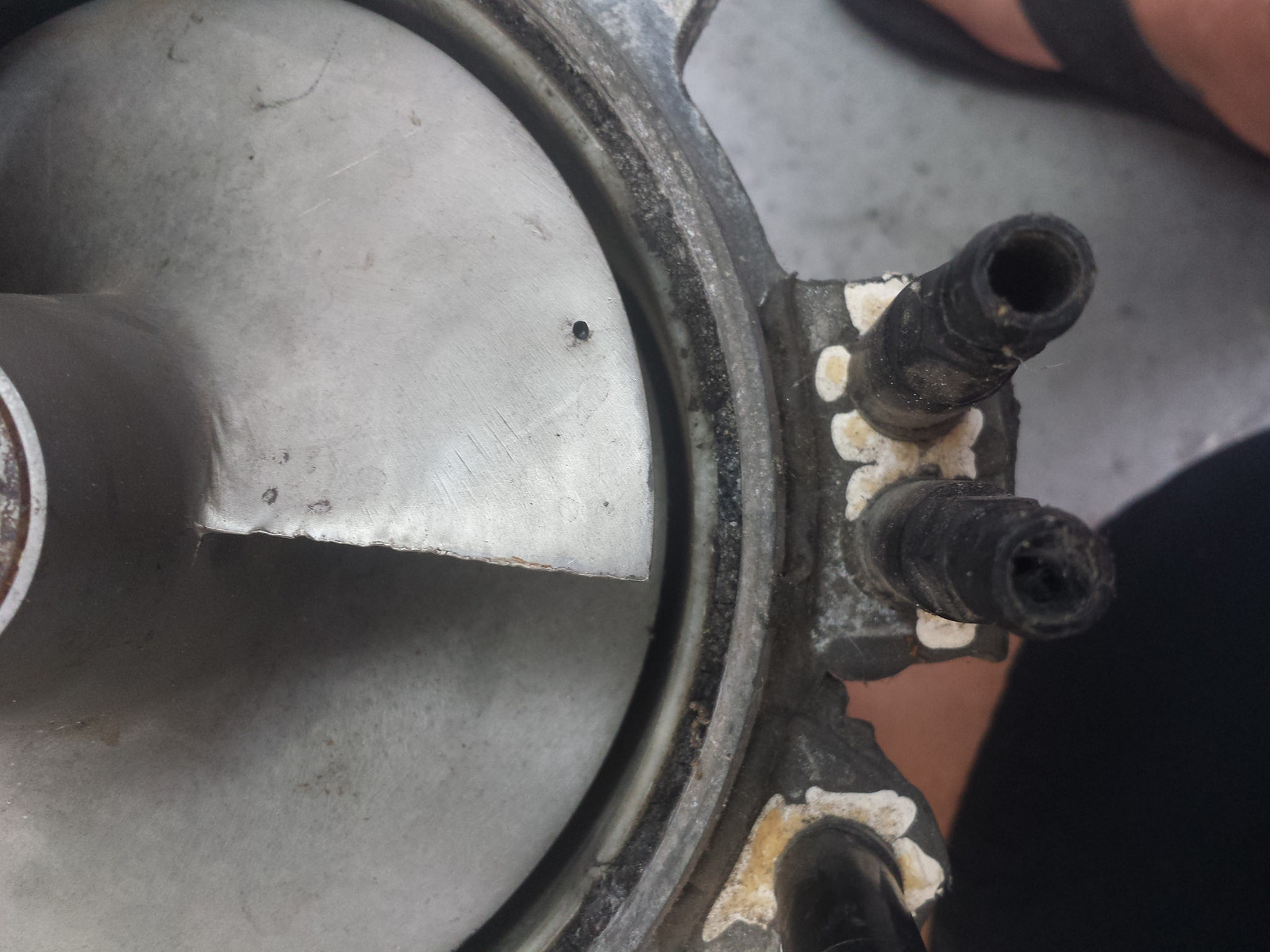

Moving on to the pump. You can see the huge gap between the impeller and the wear ring.
I cleaned the hub, bearings, shaft and cone. Everything looked great. I installed the bearing, shaft and cone. I did the 10 minute, 10 psi test with no oil. Held like a champ. Pulled it all back out, dropped the wear ring in, fresh out of the freezer, and put it all back together, torqued to 52lbs. Added 2. something ozs of synthetic gear oil and set it to the side. Waiting on the hull to pump seal.
Yes, that is the 10.00 wear ring off ebay. It fits perfectly.
