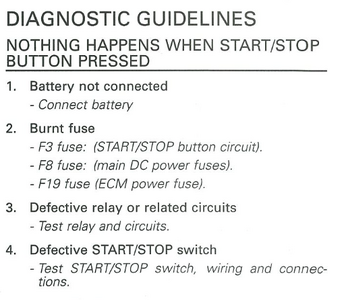

My 2016 Gti 130 was running great when I put it to bed for the winter. I recently pulled it out and tried to start but no tone with key placement, no power to the screen and definitely no reaction to the start button. I bought a brand new battery and fully charged at 2 amps. Everything remained exactly the same with the new battery. I checked every fuse in the fuse box with continuity on all. Reading several forum articles, I ordered two new 30 amp relays. Neither new relay made any difference. I checked voltage and do have 12.49 volts to the 30 amp relay. I am at a loss. Any words of wisdom are greatly appreciated.
