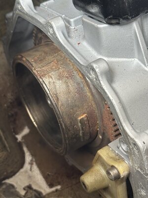

Just took the front cover off again to look for any signs of a problem. Can anyone verify if this magneto looks like it’s in the correct position. It was removed on the fly wheel, when the motor was rebuilt..never separated, and the fly wheel is keyed so obviously it can only go back one way. Front mag cylinder is at top dead center. This is the position of the raised area on the outside of the magneto cup.

UPDATE…after testing all grounds connections etc still came up with nothing. Ordered another stator and trigger coil from a different company. After comparing it with the new one already installed in the ski there was a noticeable difference in the shape of the pick up coil bracket. So although the initial one I bought technically fit…the coil was mounted too far from the magneto and didn’t do its job. Anyways. Swapped them out and tested for signal before reassembling everything and sure enough had a signal. Put it all back together and it fired right up.
