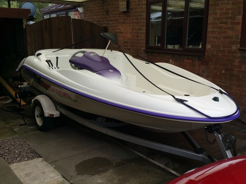

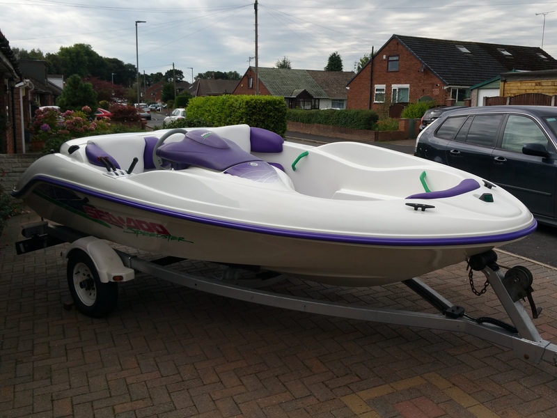

I was checking out your awesome job you did on the trailer and rememberd: you need to reinforce the beams at the apex of the Y where the two main beams come together. I tow my boat with a little Turbo-diesel, and even it had the torque required to bend it. It's much easier to strengthen it now rather than bend it back after the fact. Here's how mine looked. Notice the boat is pretty lined up with the camera...
I straightened it by chaining one end to a tree and yanking on the other with an old shitty car I was getting rid of. Damn near ripped the front clip off lol Friend was crackin up at how the headlights on that Neon were bugging out. But after, I welded triangular steel plates to the top and bottom. You might be able to achieve the same effect by bolting a rectangular piece of tubing or something between the two beams to strengthen it there.
