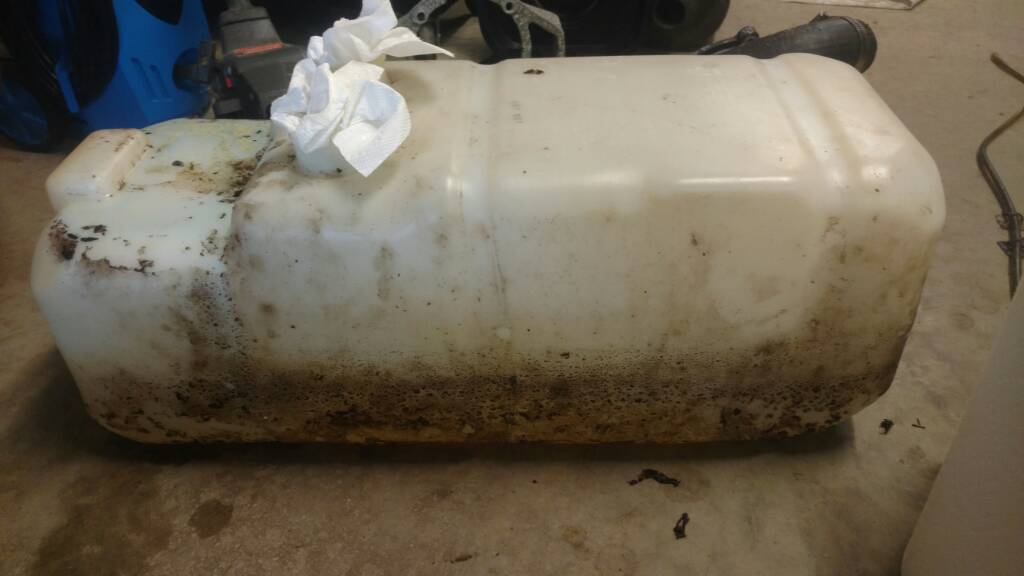

pulled the tank to clean it up and pump out the old tarnished gas and clean it up. will be pulling the motor to clean hull and give it a once over. and during this time will replace all the fuel and oil lines again..

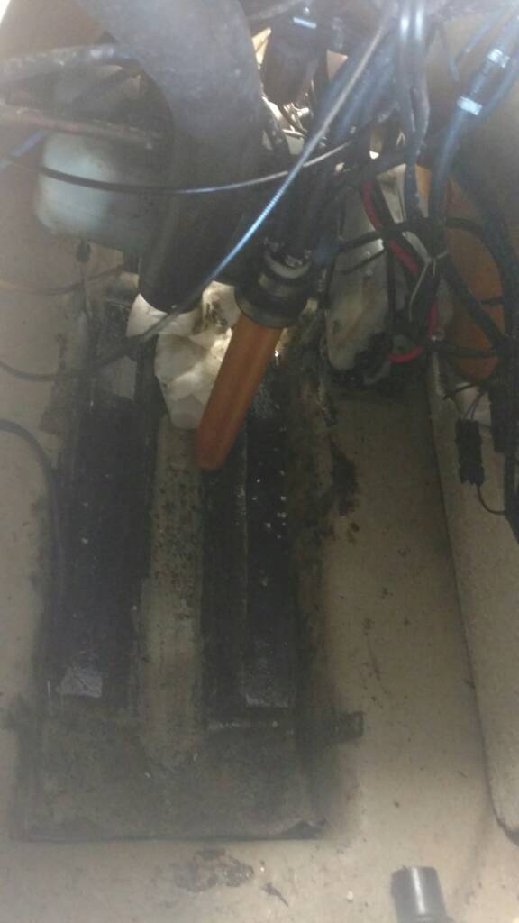

does anyone know where this hose connects? it is attached to the bung that goes through the hull to pump water out I'm assuming? it wasnt connected to anything inside the hull

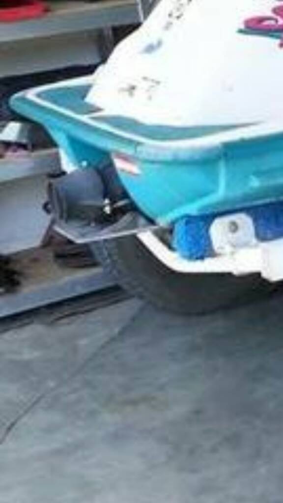

and lastly does anyone know what this is and it's purpose? I'm assuming it is not stock and it was installed on the ski when first purchased before removing jet pump. (last picture for reference)
it does and it goes to a bung that sticks out of hull? seems like a good way for water to come in. and is the ride plate a factory item? I'm not familiar with them at all
It has a check valve on it. It vents battery fumes
As for the plate, I don't know. Any manufacturer stamped on it?
I would say it helps get on plane quicker, boats use them, except they are usually spring loaded.
Ride plate extension.
no spring load on it wondering if it is even necessary or a benefit maybe others will chime in. and il have to check for a check valve if so il just remove the hose as the battery doesn't have a vent on it.. I have some of the super clean in front of hull now will let soak until morning then before work wash it out looks like il still be pulling motor though.
Google ride plate extension. That's what it is.

The ride plate is from West Coast Performance Products. They were huge back in the day but out of business for years.
The longer ride plate will keep the nose down more and stop the ski from porpoising (bouncing) at higher speeds. I say keep it on but that is up to you. It won't hurt anything to try it with it off to and see what way you like better.

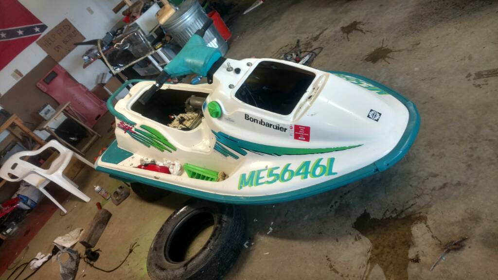

well update: let's recap I bought this ski not running with a cover and trailer for $300. little tinkering and it runs great and decided I would try my first restorstion on a jet ski, yesterday I ended up selling the trailer it came with to a co-worker for $300! so now I have a zero initial investment in the machine and time to buy more parts! (don't mind my plow was having it put on today and tested before I wait until last minute lol)
back to the ski, I have the hood taken off and have been cleaning the hull with a product other members recommended "super clean" will post up before and after pictures hopefully today when finished. I will also be removing the decals today and finally some parts came in!
