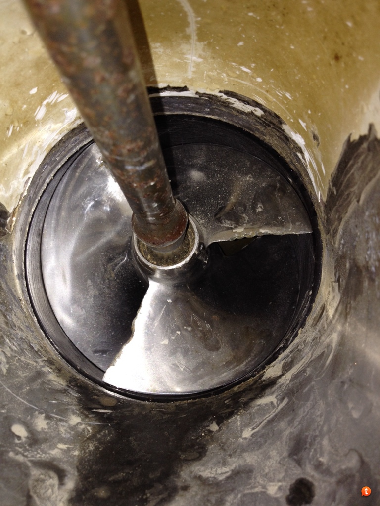

Hi guys, I juste started my challenger 787 1998 for the first time since I bought it. There is a wierd sounds coming from the impeller and i am wondering if it's normal? Seems to me like if there is something loose and if something is wrong I will call the dealer to get it fixed asap. Thanks guys

Great, thanks. First boat and I got a little scared, ill post a pic of the impeller and let me know what you think about it

Yep I agree sounds pretty normal, it's called the SeaDoo rattle and is caused by play in the impeller shaft, once you get your boat in the water and go above idle speed, the noise will stop. As far as your impeller goes it looks pretty rough also your impeller boot is missing, I would go ahead and pull the pump and get a better look also check your wear ring.
BTW never run your boat on the trailer for more than 2 minutes without providing cooling water to the carbon seal.
