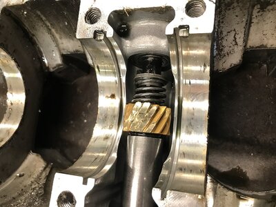

I don't ofter work on personal skis but every now and then I do... I just try to help. Gentleman just bought this ski and it wouldn't start but he was getting fire. They way he described it, I thought he had leaking inner seals. He bought the ski and bought 2 brand new carbs and installed them and I gotta admit it looked pretty from top of the engine 1997 GSX. I didn't even try to start. I decided to pull the carbs but I wanted to check the rotary valve timing. Looking through the intake I could see the gear wasn't rotating. The pictures pretty much tell the story.

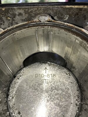

Then of course we have this mess. I'm not sure if the rave valve was the root cause ( with improper clearance) but the other cylinder was fine.

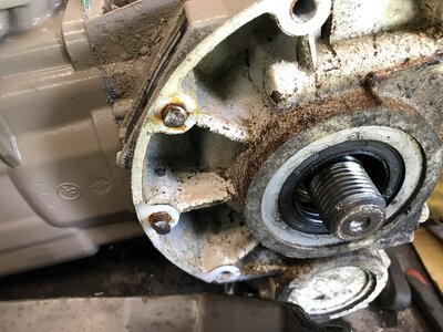

I thought perhaps the guy that put this together was just inexperienced but this starter bolt with 4 nuts on it..... man that's just way out of the park.
