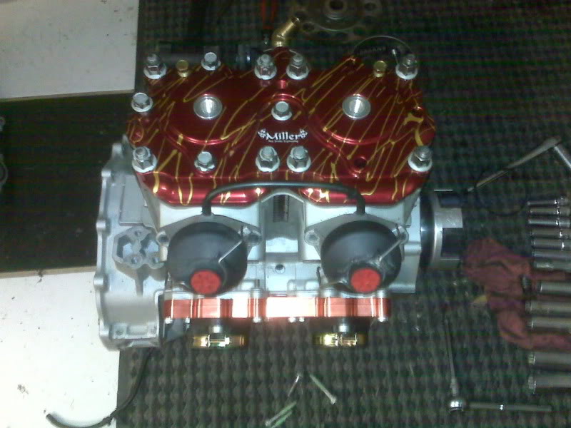

Ok I just want to make sure of two things, I take the plug caps and put them on the bolts that hold the cover on? Like in this photo they would go on the two bolts under the miller logo?
Also I am doing this one plug at a time leave one spark plug in with the cap on it and the other off and on a ground?

If you read my post it tells you what to do...stock seadoo engines have grounding posts that allow you to put the spark plug caps on them to complete the ignition circuit. The picture doesn't show the grounding posts...if that's the case, plut the spark plugs back in the caps and allow them to ground and spark on the cylinder head. DO NOT just let the caps dangle while doing the compression test they need to be grounded to metal via the spark plugs. If you don't see the spark plug sparking while the engine is turning over it isn't getting a connection to ground.

Ok sorry if I sound like a dummy, but does anyone have a picture of a 951 motor with the grounding studs that the spark plug caps go on, I really need to see what they look like im a visual learner and need to see things to fully understand so bare with me:cheers:
So I found out the the spark plug wires don't actually go any ware on the motor, they go on the coil box ware the wires come out of.

Uh Karl, it's kinda obvious that his motor is not stock.
The purpose of using a grounding lug on while doing maintenance is so you can discharge the coil so you don't build up voltage. If it comes right down to it, you can take the spark plugs, put them back into your plug boots once they are removed, then lay them down along side the engine block somewhere. This will allow your coil to discharge it's voltage.
Nice looking Miller head cover!.....
