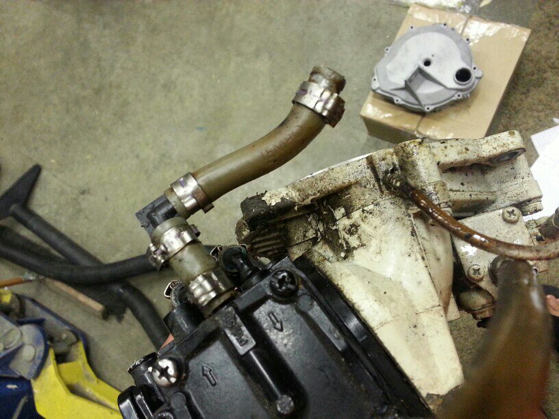

I'll take a pic of 2 tomorrow on my speedster. That's the only tempo on it, everything else was black line from the factory.

I have a 2000 GS, the pulse line is not a formed hose. What I do, is put a piece of 1/2" over top of the 1/4" hose just in the bend. It helps to keep the bend from becoming a kink. In the picture it is not in the right position but you get the idea. Put a tye wrap on either side to keep it from sliding around.
MIne is not kinked. Not new to wrenching. The engine end had a regular screw clamp the carb side was the screwed up ones! It was a Tempo line.
95 XP 720, my HX was the same. This ski is factory, my buddy bought it new in 95.
See I am not crazy!
