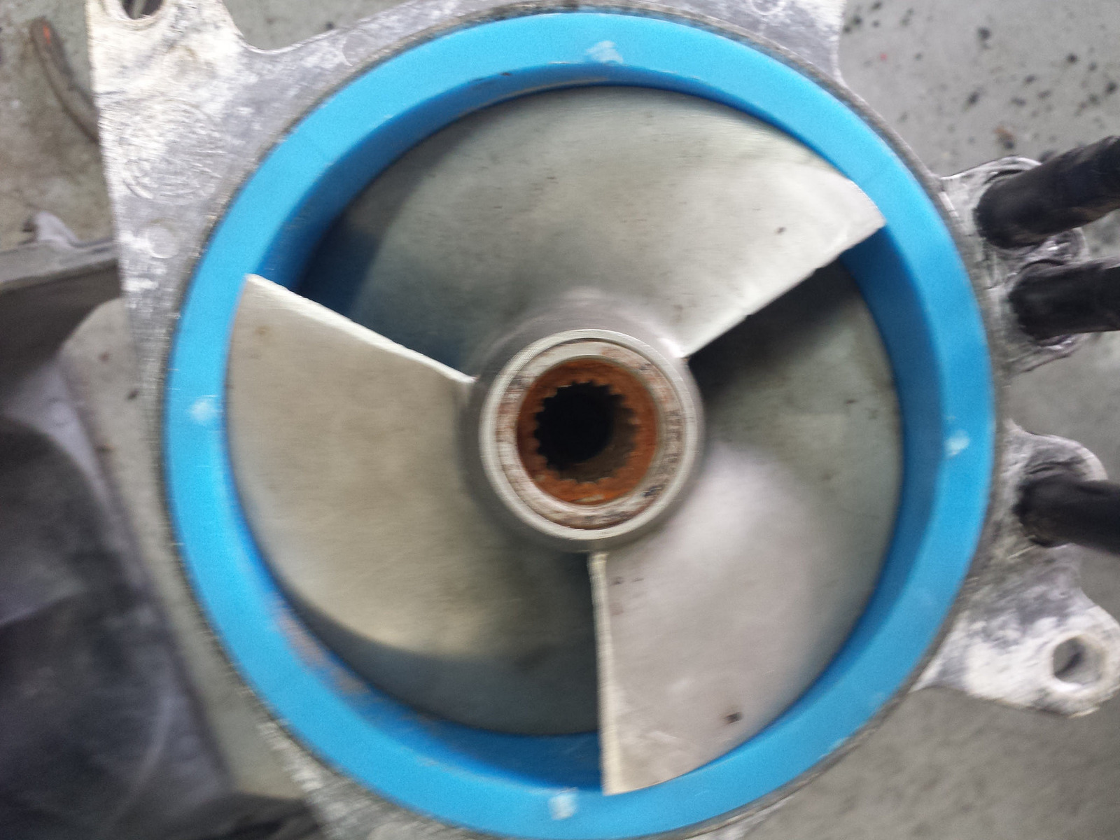

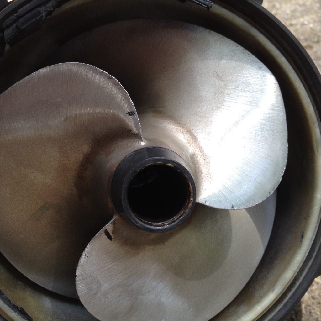

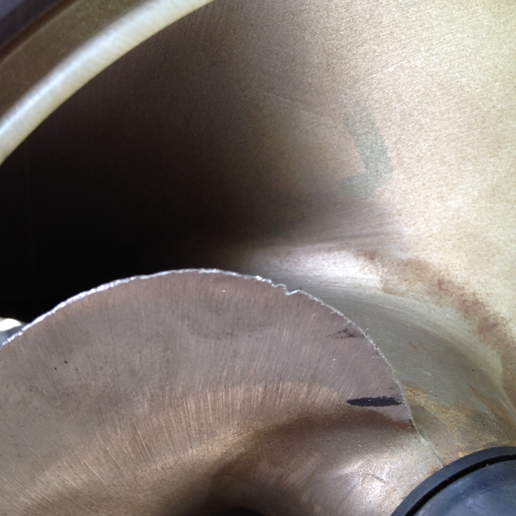

Well, the kids had the 01 GTX RFI out for the last few weeks. Son said it was perfect. Daughter takes it out over the weekend says it is "stuttering" and has lost its acceleration and has top speed of 30.
So I took it out. WOT gets to 7K rpms and the "stuttering" sounds like it is bouncing off the rev limiter. No acceleration like before. Sounds like a classic case of cavitation.
So here is the question. If the wear ring really is bad and I pull the pump, do you guys go ahead and rebuild the pump while it is out or just replace the wear ring? Ski now has 127 hrs and manual says replace seals at 150 hrs.
There are 2 O rings ( item 35 on the parts list) from the bailers to the pump. Can these be reused? I don't see them in rebuild kits. Same for Gasket, item 23 (which doesn't even show in the shop manual).
I also do not have an arbor press. I do have a drill press that can be setup to do some arbor work, but it's not the same. Reading the shop manual, it says to use a bearing install tool to press the bearing / seal assembly in. I know we would use bushings or ratchet sockets in the old days. How do you guys do this?
I will know more when I get up to the lake, pull the ski and inspect it, but since I have not done this before, I am in research mode.
