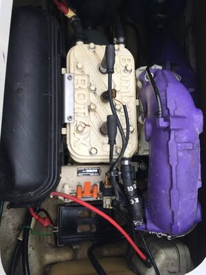

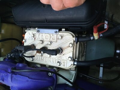

burtshaver2021 Premium Member Premium Member Jun 19, 2023 #8 The hose at the back left of the engine ( as if you were sitting on the machine is the intake and the one on the right exits through the hull

burtshaver2021 Premium Member Premium Member Jun 22, 2023 #10 There should be grounding posts to put the boots on
burtshaver2021 Premium Member Premium Member Jun 22, 2023 #11 You can see them here Just below the cylinder cover, they have the orange plastic base
