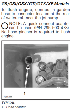

I thing they have something like this at hardware, it does screw in just below in where I was going to put my hose, correct, look at my pic
I have a 1997 GTI. In the operator's manual under the post-operation section, look at cooling system flushing.
Follow the start, turn on water, turn off water, shut off engine sequence. What burtshaver said. I have never run it this way over a minute and I don't rev it. I may be the least experienced person on here so there is that to consider.
