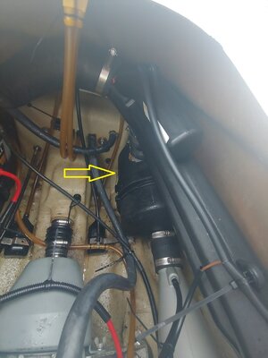

My 2000 GS started running rough and ultimately stalled. I usually find a little bit of water in side so I did not think much of it. It would not restart so I just put it on the lift and shopvac'd the water out (about 2 cups) and left it for 24 hours. It started right up after 24 hours but when I went for a short warm up it died again...found water (another 2-3 cups) in it? When I shopvac'd and dried the bilge, I dropped the ski in the water (without starting the motor) and found water coming in from an area undeneath the exhaust system (see red arrow in picture).
Without the engine running (so no vacuum bailers), I got about twice as much water (about 4-5 cups) in the bilge (in a matter of minutes)!

With the engine off (and with me sitting/putting weight on it (without the seat on)) I see water coming from (see picture).

Remove the Waterbox and inspect it and the Hull for Hole ;)
P.S. Is that a Hull crack in the photo?
Glad you saw that...at first I though it was a crack BUT it did not leak when down in the water or when hull filled with water??? I guess its a "flaw" in the composite. I may just JB Weld it anyway?
Will remove waterbox, etc...
Still planning on jacking up the front of the ski to allow more water weight/pressure in the rear section to see if I can make it leak.
Any theory on how the Waterbox could be leaking with the engine not running and the ski just sitting in the water?
Can anyone think of any hoses/penetrations "hidden" by the Waterbox
No, the waterbox will not leak just sitting in the water. That big "U" in the exhaust hose stops water from just flowing into the exhaust, it is a high point.
More than likely you have a hull leak behind the waterbox. Can be from the sponsons, a crack or the OPAS system if you have it.

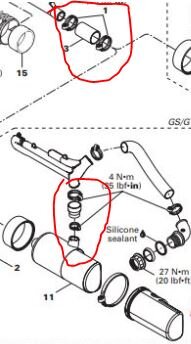

What is the secret/sequence to get the darn airbox out? I have removed the rubber strap and loosened the hose clamps...it seems to need to move aft to disengage the J-pipe? The top port is loose but I cannot seem to move the airbox aft enough to get it off the J-pipe
Waterbox not airbox I assume.
You need to break all the hoses loose.
I would remove the upper J hose and plastic baffle first. Then you should be able to lift the waterbox up and off hose #3.

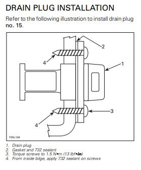

Okay...I found one of my hull drain plugs does not have a rubber O-ring (the other does and no leaks on that side). The bilge drain plug is "captured"...how do I release while retaining the capture mechanism?
I will try that...tomorrow. I replaced the missing drain plug O-ring and that seems to have reduced the amount of water coming in from the unknown source. I am wondering if its leaking around the threaded drain plug receptor/receiver.
Got exhaust out of way...looks like water is coming from the underneath the floatation foam, most likely hull/deck seam.
