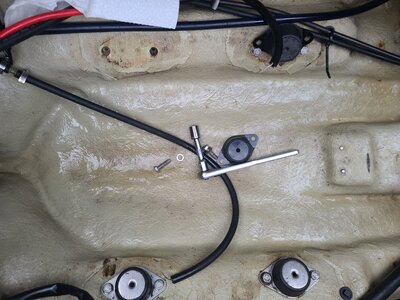

Hey guys, had a broken motor mount, so i took the motor out, cleaned out the hull, rebuilt the carb, and was about to put the engine back in l, but decided to remove the oil pump to bench test it since the oil lines were plugged and try to set up the engine with the oil injection again. While trying to put the oil pump back in, I dropped the split washer from the last 5mm Allen screw through the open port in the rotary valve on the PTO side.
I know I should have put a rag, and I was thinking to myself to put a rag in there before I drop something in, and in it went.
That's not the worse part, the worse part is that I tried to take the engine head off and cracked the 1st 11mm bolt loose, and the 2nd one the head broke off.
The engine in question is from a 1997 GTI with a 717 engine single carb.
