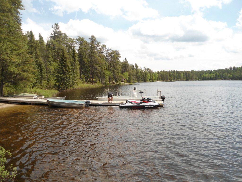

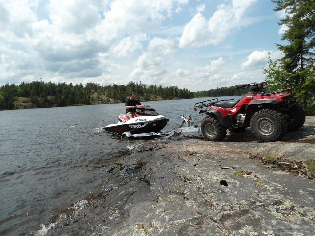

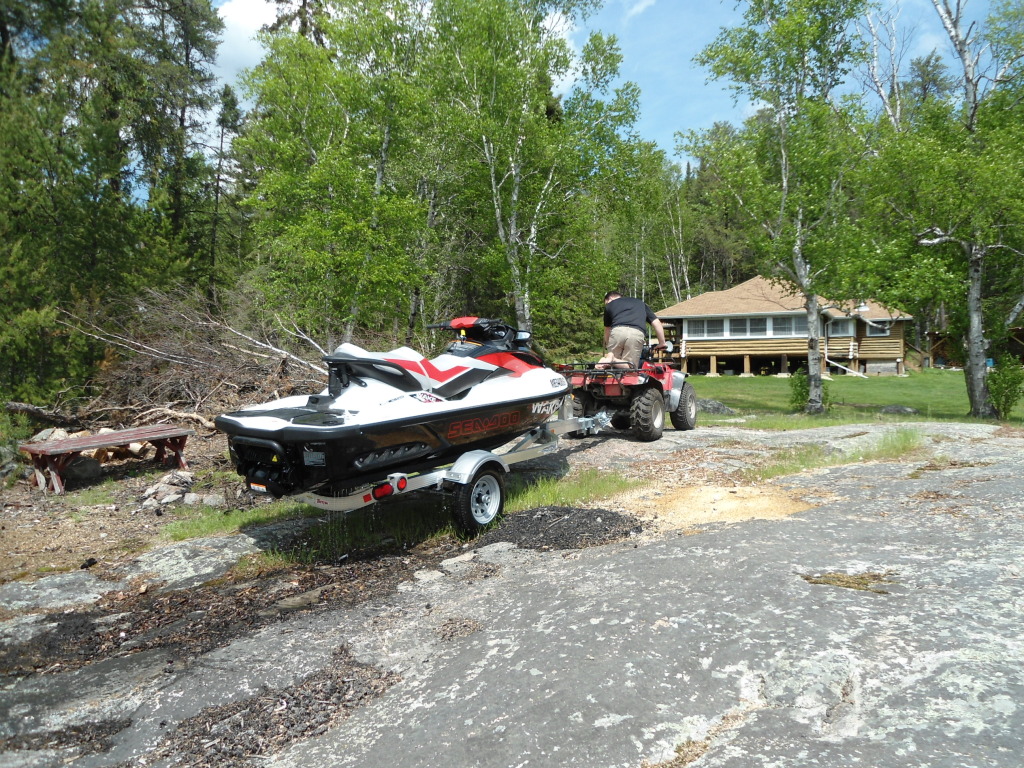

Here's some pics of it:
Nice pics last 1 didn't upload fully but looks like a nice place you have there too! That rocky shoreline gives me the eeby-jeebies though!
- Michael
Okay...I see something to beware of.....
Get the trailer deeper in the water before you ride the ski on or...get off the ski and manually winch the ski up into place. You don't understand the volume of water the intake will draw when under even minor load. These skis intakes are more than capable of lifting fist size rocks off the bottom of a concrete ramp.

I never ever drive my jet propelled watercraft off of nor onto the trailer, I always pull them on or off the trailer by hand then guide them out to the end of the pier or wade them out to chest deep water and drop the anchor, then go put the vehicle up then go back to the watercraft and untie or pull the anchor up and start the engine.
Red2Blue is absolutely correct these pumps will suck good sized rocks up from 2-3 feet below the intake. You should be in chest deep water before starting the engine everytime. Good point! And never EVER let anybody dangle their feet below the hull while the engine is running, for OBVIOUS reasons! I've seen people do the dumbest things and then cry out loud that they're going to sue because they got hurt... Grrrr!

The picture is deceiving. The rock cut where the trailer is parked drops off about 3 feet. it's an abrupt climb from the bottom. That's why the trailer is only parked that deep, any further and the trailer will be completely submerged. The trailer bottoms out before it completely drops off anyways. It's all smooth rock as well with no loose rocks. We use the rock for loading and unloading all our boats and will be making a ramp soon as my brother wants to load his Campion from there. We'll see how that goes since his boat and motor is a lot heavier then the other stuff. It may be a quad and winch to pull it.
We have since changed practice regardless loading and unloading at the ramp and shore. When we load it the wife drives up shuts it off and then I guide it up onto the trailer and then hand crank it. When we unload she is on the machine and then I push her off. Fires it when she is in deep enough water. Seems to work well. If I'm by myself unloading I just rock it free and then let the wind carry me to deeper water. Loading I give it gas and then shut it off and drift or paddle it to the trailer. I have chest waders from quading for the spring and fall when the water is unbearably cold for loading and unloading.
