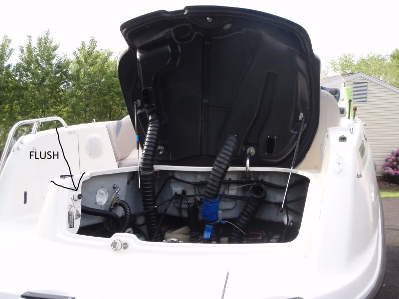

Here is a link to the video I took in the bilge. What you are looking at is the starboard, aft side of the engine. The boat was on the trailer with the fresh water flush hooked up. This was very helpful to me as I was able to study it by slowing and replaying several times in the comfort of the couch and not curled up in impossible positions in the bilge. You can see at about the 2 sec mark at the bottom left of the screen and again at the 9 sec point exactly where it was leaking. This was the gasket between the engine adaptor and the pump housing (engine adapter needed some JB Weld to fix a gouge right where it was leaking) It was a $25 part and the o-rings were another $5. I bought a used engine hoist on CL for $125 and needed the lifting eye for $35. So for under $200 and about 5 hours of labor I was fixed.

Yep... I agree. That's very strange. I don't think I've ever seen a mount crack like that.
I would yank the engine, and get a better look. If that is the problem... it can be welded.
