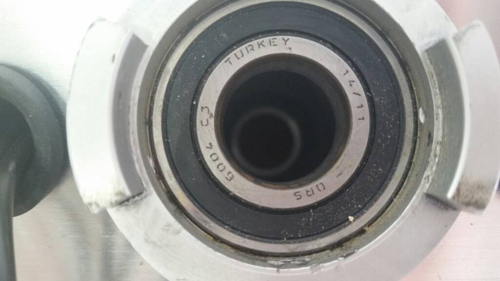

What do you guys think about rebuilding your own counter balance and rv shaft? Is it worth the trouble or should I just buy already rebuilt ones? It looks pretty straight forward but I've never done it before.
I build my own. I use a 2 jaw puller on the cb bearings, then use the press to put the new ones on. On the rv shaft you need an internal bearing puller from harbor freight. If you look in any of my build threads you can see them. I think my 95 and 98 have decent pics on them.

As long as the oil seals are good on the counter you just have to swap out the bearings

I can you help you out with this one. They are 42 mm OD x 20 mm ID x 12 mm Lg. Koyo part #6004 2RSC3.
I have 4 of them on my desk.
Here is what I just installed from Atlantic jetsports. $21 but I'm sure they are cheaper to order separately.
Dang, $19.49 for 10 from amazon [emoji58]
