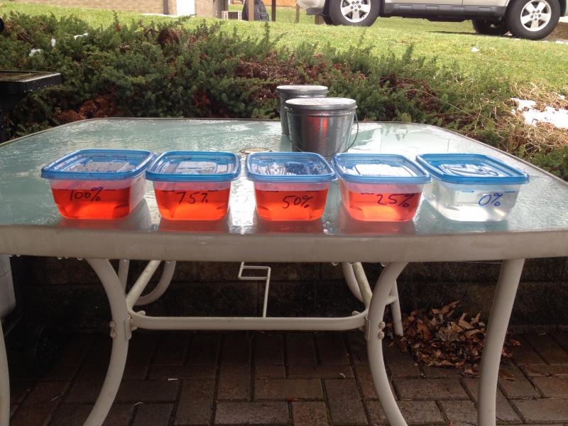

OK... on my local boating chat board, (boatpittsburgh.com) we were going back and forth on RV antifreeze, and it's effectiveness if it gets diluted. My stance was, it should still work, but not as well as the proper mix. (FYI, the proper mix is 60:40, but that's how it is in the bottle since it's "Ready to use") So... the scientist in me couldn't let it go. AND... since this is good info for the seadoo guys... I thought I would reflect my findings here.
So... here's the experiment.
In the containers below, there is 475ml of fluid. The 2 end containers are our controls. 100% is right out of the bottle, and 0% is tap water. Even though, the "Bottle" of RV anti-freeze is a mix, for simplicity, we will just call it 100%. Also, I was going to use bottled water, but I figure most of us would be diluted with either water from the hose, or the rivers. Either way, it will be full of "Other" stuff, that could effect the freezing point.
Then, as you can see, there is a 75%, a 50%, and a 25%. If you guys would like to see a 10% or some other mix... I will make one.
Finally... take note, that on each container, there is a couple lines. That (more or less) marks the top level, so we can see what expansion happens as it gets cold. This is important since the RV claim is -50 Deg F. BUT... that's a burst pressure. So, I will assume it will start to gel, and expand at some given temp.
The test will be simple. In the morning (and days to come) I will check each for liquid or ice. I will report on what I find.
Date: 12-7-13
Time: 8 AM
Temp: 27.8 Deg F
100%: Liquid, no expansion
75%: Liquid, no expansion
50%: Liquid, no expansion
25%: Liquid, no expansion
Notes: Strange observation this morning. It was below freezing for at least 10 Hrs. The containers are on a table, under my deck. The water that dripped from the deck above, and onto the table was frozen. (The containers were sitting in ice) BUT, the container with straight water had no ice in it at all. The plastic must impart more insulation than expected.
Note 2: Time: 3:30 PM; It's been below freeing all day, but there is no change. The sun obviously kept it warm enough to stop the freeze.
Note 3: Time 8:30 PM: Temp 24.5 F; The fresh water is showing ice now. It's still very liquid, but there is ice forming around the sides, and top edge.
Date: 12-8-13
Time: 10 AM
Temp: 23.8
25%: Liquid, but icy. (about like a thin Slurpee) no expansion
0%: Very little Liquid. noticeable expansion. Engine block damage probable
Notes: It has been below freezing for at least 32 hrs at this point, and it was down to 21.3 Deg F overnight. The fresh water is almost frozen solid, and I can tell that there is some bulging of the container. In my opinion, even though the ice isn't solid yet, there could be enough pressure to cause issues. Possibly not a broken engine block... but the extra pressure on seals, and gaskets could cause leaks in the spring time.
Note 2: While swirling the "25%" container, to get a view of it's consistency... I noticed a few drops getting out past the lid. Because of this, the "Top level Lines" may be invalid now. BUT, if there is a solid expansion, I should be able to see it in the container walls.
Note 3: Even though there is some ice crystals forming in the 25% container, there is no way that there could be damage to your boat at this point. The MIX is simply too soft and fluid.
Date: 12-8-13
Time: 6:30 PM
Temp: 28.2 Deg F
0%: No Sign of Liquid. noticeable expansion, and the container is bulged. Engine damage is HIGHLY PROBABLE.
Notes: At this point, we have had a 48 hr freeze soak. Most of that time has been in the mid 20's As you can see above, the fresh water would now have cracked an engine block, or at least stressed it. AND, even though the 25% is slushy... there really isn't any "Solid" sections in it, that could cause damage. (IMO: it's still in the safe zone)
Date: 12-9-13
Time: 10:30 AM
Temp: 35.7 Deg F
Notes: We had a small thaw last night. It's only been above freezing for a few hr's, but the 25% is all liquid again. The fresh water is still solid. It's obvious that even at 25%, the anti-freeze is doing some work.
