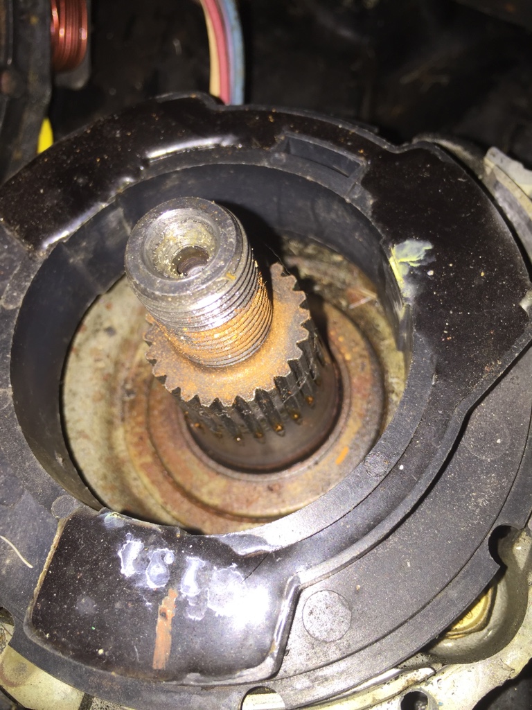

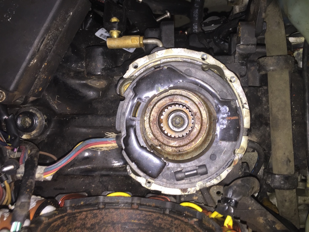

So... I would pull the flywheel, and get a look at everything. Check the stator, and the trigger. AND... look at the wires, and connectors on each.

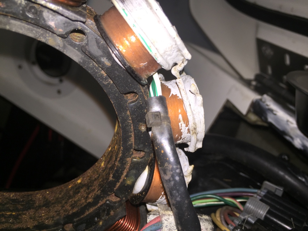

Everything looks pretty good, no obvious issues. One stator wire was saturated in oil, but it was spongy not brittle and the continuity is good
Surface rust isn't any issue... so no real reason to clean it.
Check the coils in the stator with a meter. Make sure nothing is open... or shorted to the iron laminates. (sometimes they short internally)
Stator looks ok, none of the lines from the rectifiers are shorted to ground and there is continuity in the two pairs.
