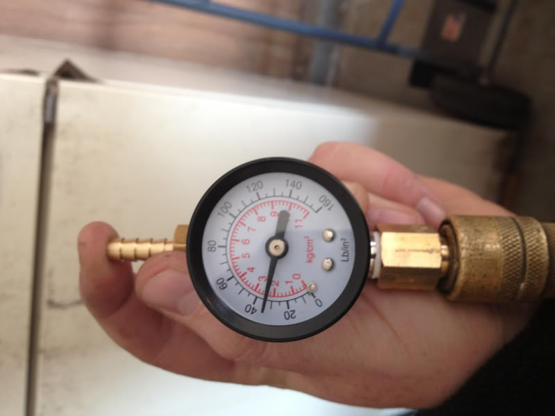

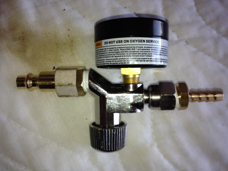

There are only 3 parts that you have to buy, and they all came from LOWE'S! Go to the air tool section, and all three of the parts should be in about a 5 foot area.
First part was a quick connect with a female end.
Second part was this awesome air pressure regulator (I think used for paint guns). It has a built in gauge and a knob that controls the pressure.
The last part was a 1/4" barb with a male connector, that connects after the regulator, that barb is for the hose that you will connect to your carb.
![IMG_0106.jpg IMG_0106.jpg](https://www.seadooforum.com/data/attachments/12/12395-999055c5e493ff06222e58c711152d6c.jpg)
![IMG_0116.jpg IMG_0116.jpg](https://www.seadooforum.com/data/attachments/12/12396-09c691c69972dcc7d5dfa87bbea8fc7b.jpg)

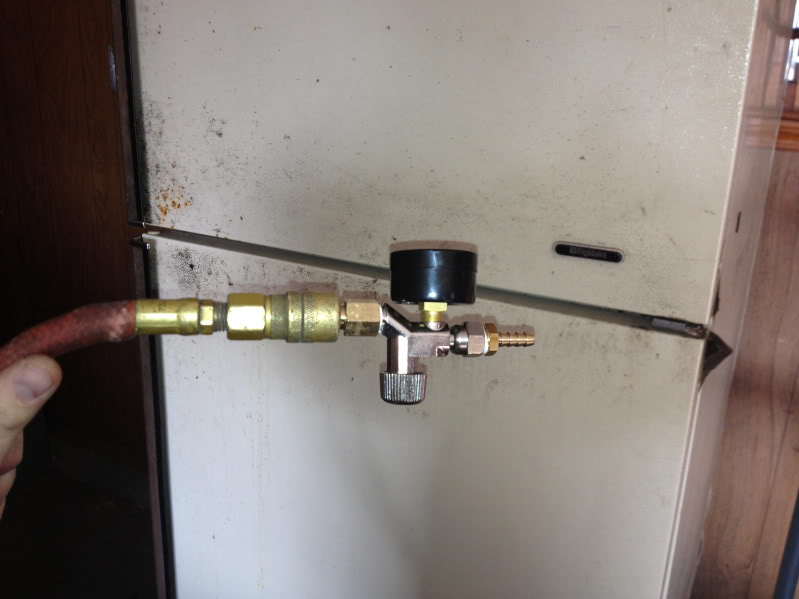

All in all, I think it was $15 for the regulator/gauge, $1.50 for the quick connect, and $2.00 for the barb connector. I was going to go the route of buying a separate gauge, a t-connector, and an airflow shutoff, but it was cheaper buying the all in one piece. Also, the knob gives you really accurate control of how much pressure you are releasing.
![IMG_0120.jpg IMG_0120.jpg](https://www.seadooforum.com/data/attachments/12/12397-ab3c28e02d54f15812166b7648abed8e.jpg)
Lastly, when you put the pieces together, make sure that you use plumber pipe thread tape to make sure there are no leaks. Hope this helps some of you...now if maybe someone can give me the procedures for doing the pop off test, then I will really be in business. Thanks!
