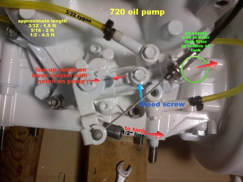

Ok so first off I am boat dumb.. And esp jet boats.. So I traded around and ended up with a 98 1800 sportster with twin 717 . Kinda worried bout taking it out on water by myself just cuz I don't know the boat . And I have no friends that has boats that can go with me lol. But my question is.... How can I tell is it has had oil block off plates installed ? Guy I bought it off of said it did.... But I would like to confirm that.....better safe than sorry

below is typical 717/720 engine carb side tipped on side
A - oil injection pump would be replaced by blockoff plate
B - 1 input and 2 output into/from oil pump - would be blocked off
C - oil supply line to RV (rotary valve) gears - should be connected to oil tank and have oil in the line
Your Sportster engine's originally were equipped with these pumps, this pic was created by another forum member as an aid to servicing the pump lines and adjusting the output flow. Where you see the stainless cap screws in this photo, the pump and lines will have been removed and a block off plate fastened over the hole. This is located directly under the carbs/rotary intake on your motors.

Looks like Rod beat me to it :) Or not? Where did that cool pic go?
Also check that the oil tank is still installed and not removed. There should be 2 oil lines going to the tank. 1 line will go to the nipple that says "1/2" line to tank" in the above pic, the other line will go to the nipple in this pic on the exhaust side of the engine. This is necessary to keep your rotary valve gear lubed while running premix.

Ok awsome! Thanks guys. I just had put carb back on there when phone notified me bout the replys. So after feeling under carb. I can verify they r block off plates installed and the big hose is capped off ! So just knowing one way or the other gave me a peace of mind . Although I did find something odd .... underneath bth air filters they r a rod laying in .... I will take a pic and see of I can post it thru phone ! The pics where very helpful!!! :beer:

~Carb linkage pop off Miller ? [MENTION=59978]kicker[/MENTION] I think you deserve honorable mention for making those great pics of the oil pumps and replacement lines, well done those are a huge help to people learning these engines for the first time.
