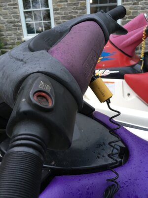

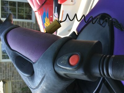

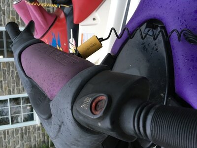

I purchased a couple of the replacement start stop red covers from OSD. I’ve read that you simply pick the old one out and wiggle the new one in but wanted to check with everyone here before I picked the old one out.
5BDDA28A-F68A-4759-BEF6-7AB3568E540B.jpegI have a replacement start stop button from OSD,I read on SBT website to just pry the old one out and push the new one into place. is that all there is to it? Thank you
Take a pick and remove all the red ring and then just slide the new red starter button cover in that spot.
