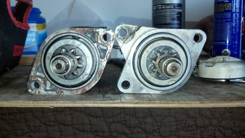

The good news is my eBay starter arrived early today in time to install for the weekend. The bad news is, it has an extra mounting lug:
It looks like it'll still work since the extra lug looks like it'll be pointing towards an empty space. Fingers crossed.
The one on the left is for a 580 or 657 Engine
The one on the right is for a 787 engine
I can't remember which one the 717 engine uses.
Never tried switching them though. Somebody else one here will know.

The starter on the right is just like mine out of a 717. The mounting hole is for your negative ground cable.
