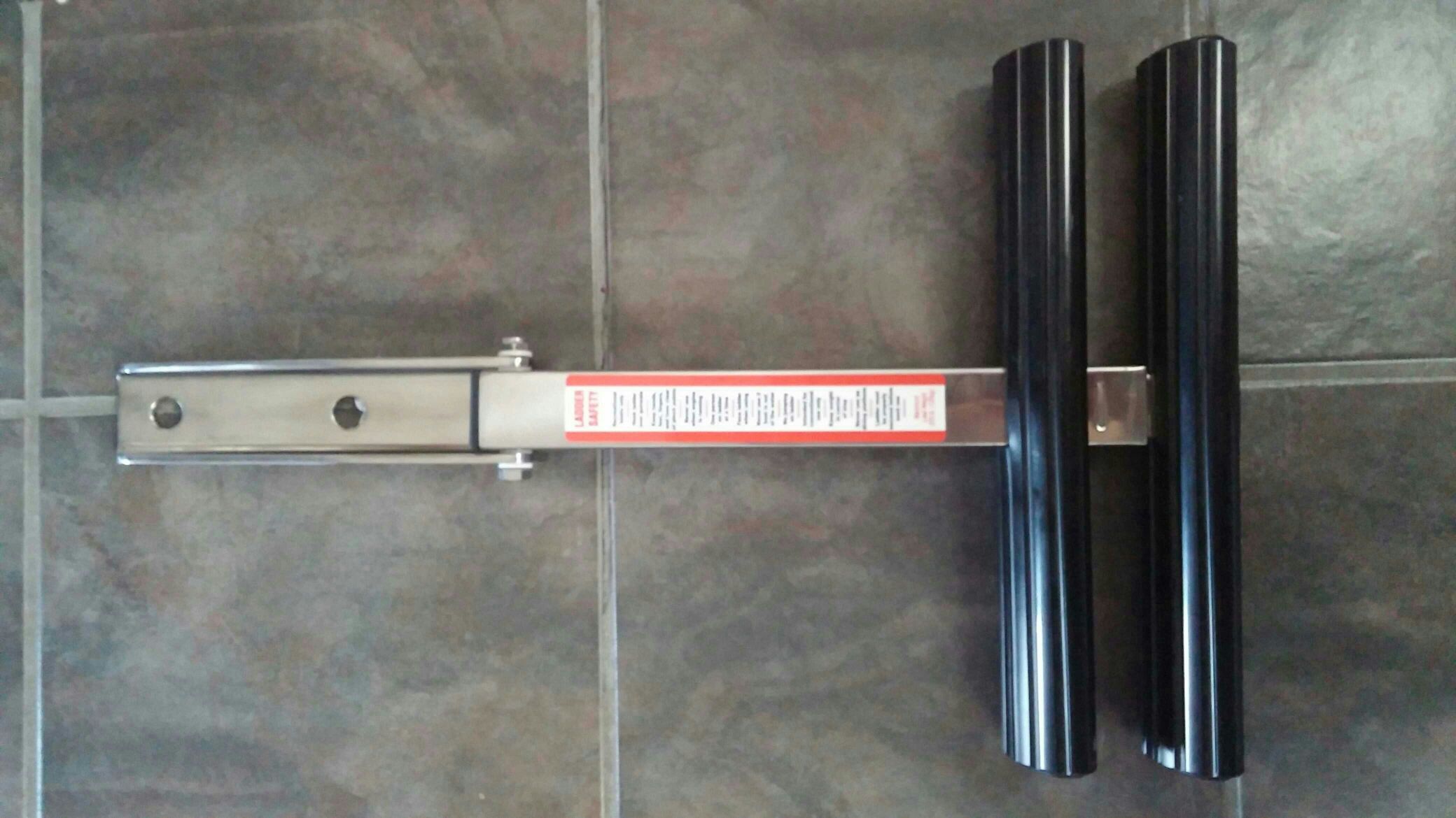

Greetings fellow boaters! I have a 04 sportster 150 and I purchased a ladder from our good friends at west marine. My original plan was to use the existing mount on my boat to secure the ladder. No dice, of course it will not fit with it being square and an inch or so thicker. Is it possible to get the under swim platform bracket for this ladder and replace the factory one? Im scared to drill holes in the bottom of my boat and am not sure how to patch the old ones. Has anyone else had experience replacing their factory ladder? Thank you as allways for your help!

Did you check and see if the added thickness will interfere with your bucket movement when up? It might be easier to return the ladder and purchase an OEM through the forum...
Thats what I was afraid of hearing :( I just cringe at the $400 price tag for an oem part.
Sent from my VS980 4G using Tapatalk
I have done this before. It's not bad.
1) Put your bucked in neutral to get at the bolts.
2) remove your old bracket.
3) Test fit the new bracket and ladder to see if it will even work with your retaining rubber thingies.
4) Test fit the ladder with the bucket if you can get the ladder to stay up. Put it forward, neutral and reverse
5) examine if there are studs holding the existing ladder, if so go to welding shop with the old bracket and have them fabricate a new bracket by welding a flat stainless onto your new bracket.
6) Install and your done :-)
