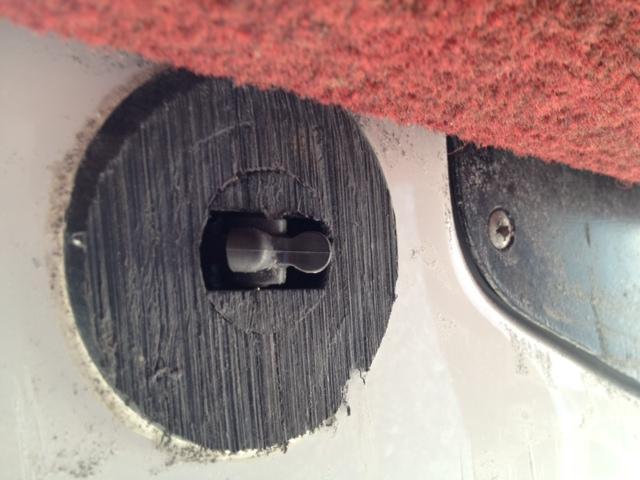

Hey Bmann, I finally got my boat onto a trailer to look underneath the lower hull. One of the drive plate got scraped pretty bad. I also notice the black plastic round piece underneath there that got scraped pretty bad as well. I looked all over the seadoo parts list and can't find anything on it. Would you happen to know what it is? It's like a 2in black plastic piece that's somehow glued onto the boat. There's 2 of them from what I saw but only one got damage. Thanks!!

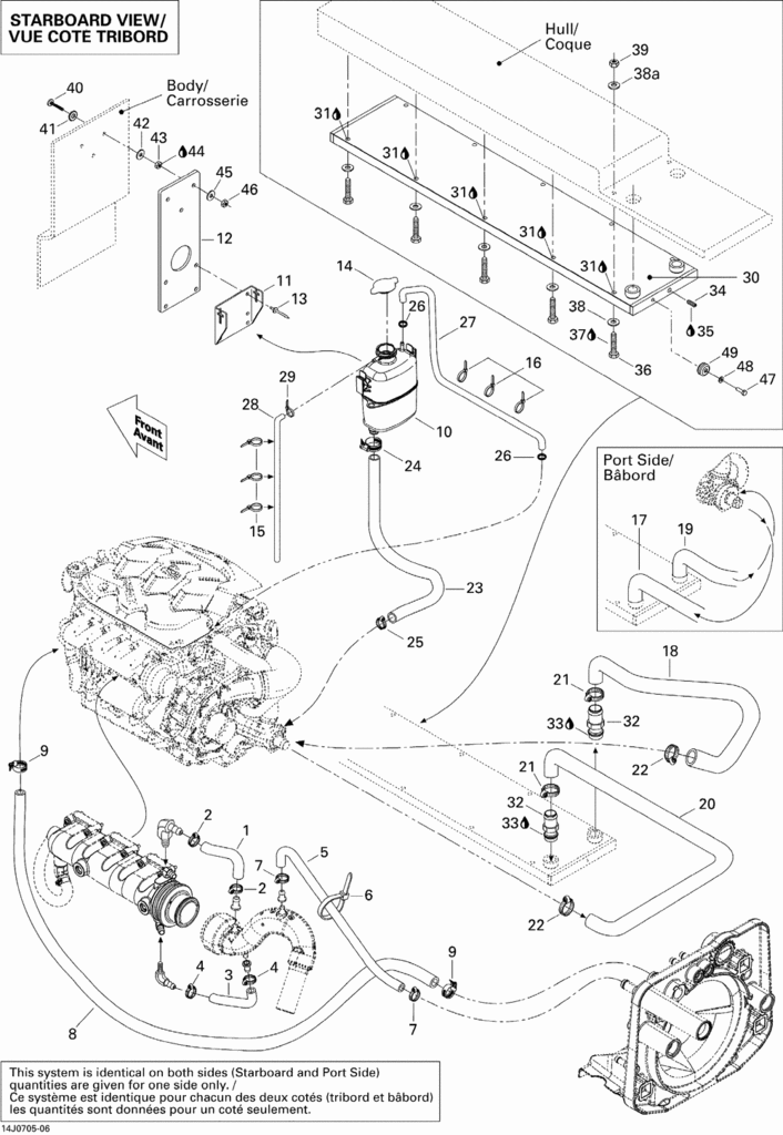

I think what you mean are the heat exchangers, they're the equivlant to your rad in your truck, if theyre cracked you would have coolant leaking. Here's is the fiche pic of the cooling system, part 30 is the exchanger ... is this the piece thats damaged?
Thanks for the quick reply bro! No, that's not it! I have to take a picture for you to see it. It's close to the drive plate and the grille on the lower hull. It's just a black plastic circular piece. Is your boat on a trailer?
Nah it's in the water ... if you can post up a pic ... once I see it i'll be able to help you out. There is a ride plate though ... that could be the only other piece that matches the description.
Bmann, if you look at the first picture. You'll see a small black dot. There's one on the other side of the boat as well where it got scraped really bad.

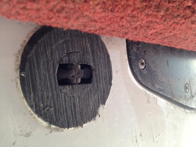

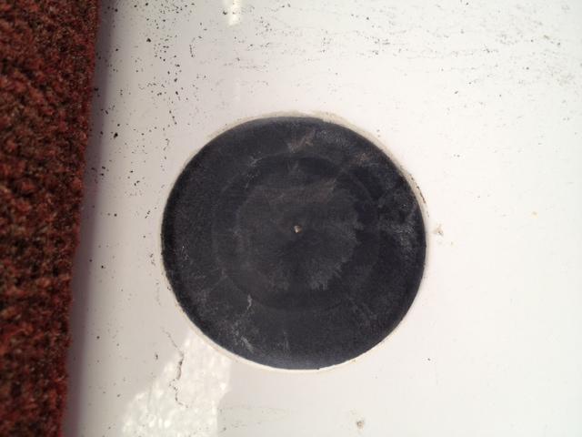

K I crawled underneath the boat and this is the best picture I could take of it. The one that's all scraped is on the driver's side right behind the ride plate. Then there's the one that's not scraped and that's directly across on the passenger's side.
Ahh looks like speedo, and the depth sounder ...ill be pulling mine outta the lake tomoorrow ill get under there and post back.
